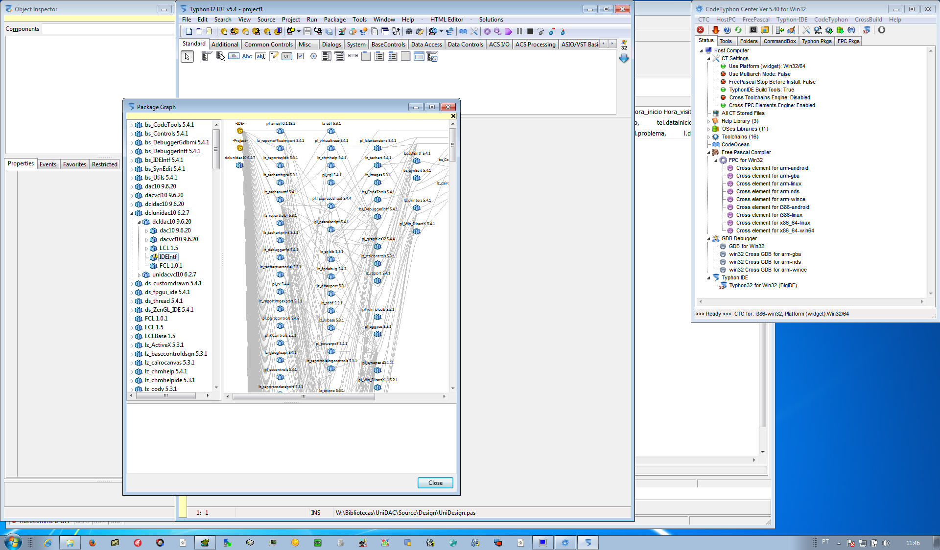

I’m using Unidac with Delphi and Lazarus
In Lazarus I can install unidac without problems but on CT appears the Package graph with IDEintf with yellow exclamation.
Can you help please
Thank's

Unidac with CT 11 years 4 weeks ago #8118
Typhon IDE Don't has IDEintf
Remove IDEintf and
ADD bs_ideintf package
