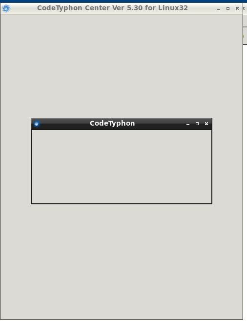

Sternas,
I am still trying to wrap my head around this.
Config:
CT 5.30 , Ubuntu server 32bit , LXDE desktop
Codetyphon center fails with some sort of exception which is not displayed. (Screenshot attached)
Is CT supposed to work on Ubuntu 32 bit with any desktop at all?

Sternas,
I have installed Lazarus 1.4 32 bit on the same machine (Ubuntu 14.04 32bit, LXDE) and the IDE freezes at startup the same way CT does. So it is not a CT specific problem.
Last edit: by Leslie.
FPC32 units are missing 11 years 4 months ago #7355
  • Leslie
  • Leslie's Avatar Topic Author
  • Posts: 66
  • Thank you received: 4
Sternas,
I have done an other test with a Virtualbox guest with the same config. CT works fine there.
The machine where the problems occured is located in the cloud at DigitalOcean. So the problem relates to something specific there, not to CT.
Cheers
Leslie
