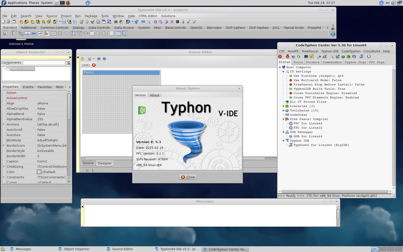

Screen1 (now) from Fedora 21 (64bits) Typhon build with QT4 API

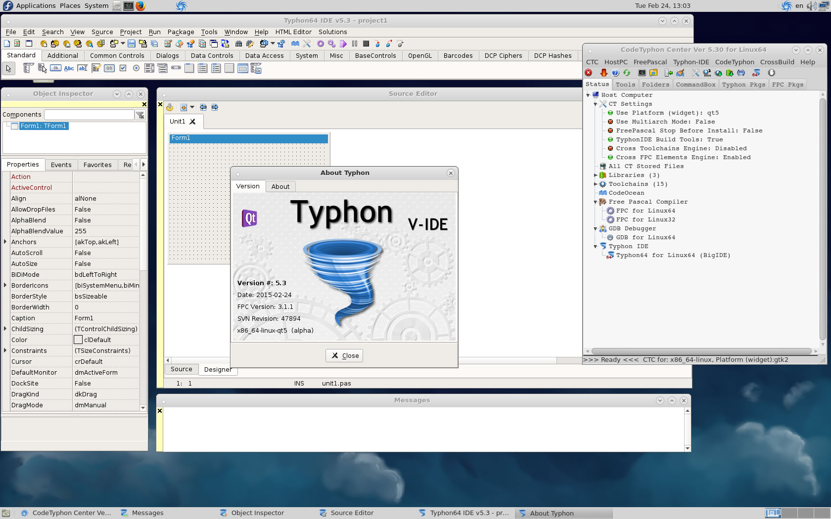

Screen2 (now) from Fedora 21 (64bits) Typhon build with QT5 API :woohoo:
