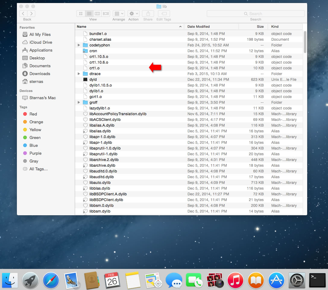

/usr/lib/crt1.o is basic OS library
Did you "Activate" XCode?

Install into Mac OS X problem (us and french) 11 years 6 months ago #6843
NO NO don't pay anything,
simple open XCode and accept the license
or exec to a terminal
xcode-select --install
sudo xcodebuild -license
The following user(s) said Thank You: DUBOIS
