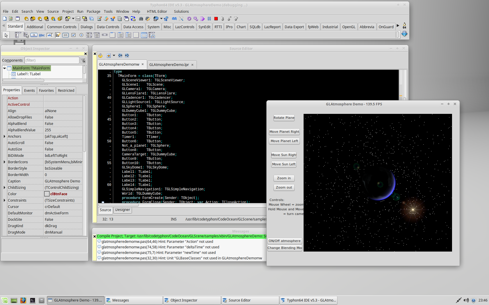

Component Tabs missing on Linux Mint 17.1 Install 11 years 7 months ago #6742
We finish the quick test
on Linux Mint 17.1 “Rebecca” with Xfce 64bits (linuxmint-17.1-xfce-64bit.iso)
with out problems:
--ORCA
--GLScene
libraries....

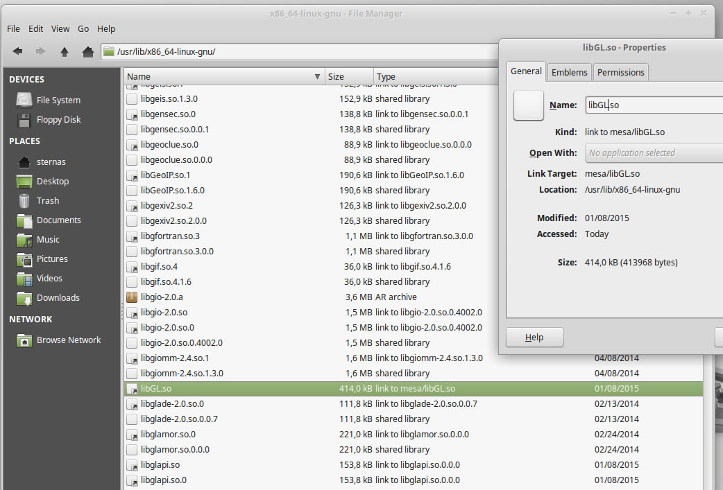

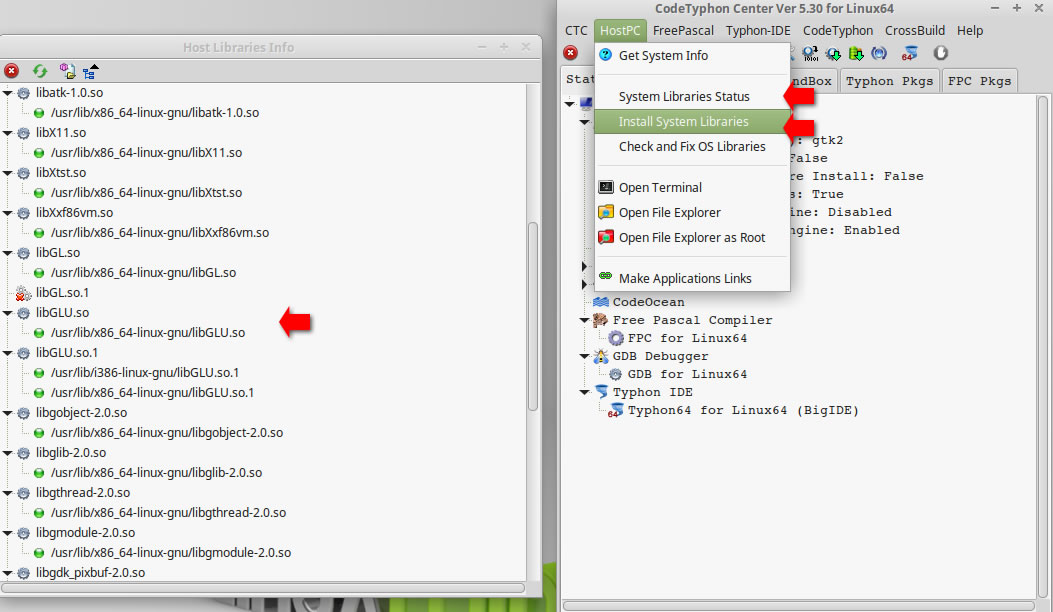

Component Tabs missing on Linux Mint 17.1 Install 11 years 7 months ago #6757
the problem is that we don't use Parallels in our lab
my suggestion is to setup Linux MINT 17.1
Normally libGL.so for Mint/Ubuntu/Debian is in /usr/lib/x86_64-linux-gnu/ directory for 64bits OS
if this link is broken, then you must install OpenGL driver again
Retry to install "System Libraries" from CTC =>HostPC => Install System Libraries action
you can see these "System Libraries" from CTC =>HostPC => System Libraries Status dialog
