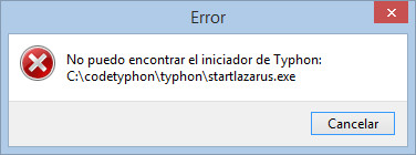

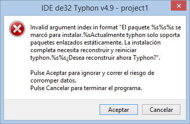

When install a new package i obtain the dialog in instpak.jpg and need execute build CT from Tools menu. After this, CT not restart automatically with error in restart.jpg (i suppose need modify main.pp replacing 'startlazarus' string for 'typhonstart').

c:\codetyphon\typhon\ide\main.pp
Hardcoded "startlazarus" has to be converted to "typhonstart"
By the way, in CT, the corresponding exe is "typhonstart" (with "start" at the end) while in Lazarus it was "startlazarus" (with "start" first).
This should help ;)
Line 6936
DarwinStartlazBundlePath = 'lazarus.app/Contents/Resources/startlazarus.app/Contents/MacOS/';
Line 6957
      {$ifdef darwin}
      ExeName := AppendPathDelim(EnvironmentOptions.GetParsedLazarusDirectory)+
             DarwinStartlazBundlePath + 'startlazarus';
      {$else}
      ExeName := AppendPathDelim(EnvironmentOptions.GetParsedLazarusDirectory) +
        'startlazarus' + GetExecutableExt;
      {$endif}

Strange behavior installing packages in CT 4.9.2 12 years 1 month ago #5731
Guys the problem is in *.po files (codetyphon/typhon/languages)
we try to fix and these problem
