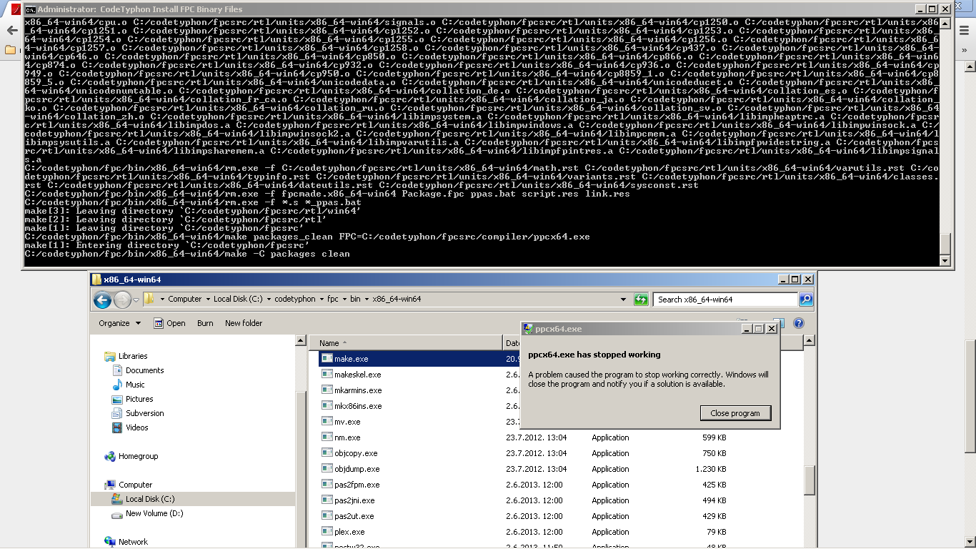

One screen shot
Regards, Dinko
Installation hangs 13 years 2 months ago #4231
Sir,
I think the problem is your AntiVirus Kaspersky
try to build CT with out AntiVirus protection in CT folder
Installation hangs 13 years 2 months ago #4237
  • Dinko
  • Dinko's Avatar Topic Author
  • Posts: 91
  • Thank you received: 5
OK. This was helpful.
Problem was solved by uninstalling Kaspersky completely, restart, and CodeTyphon install.
Probably Kaspersky services stop will be enough, by I did not try
Interesting. With Avast AntiVirus Started on some other machine installation was OK.
Thanks, Again.
