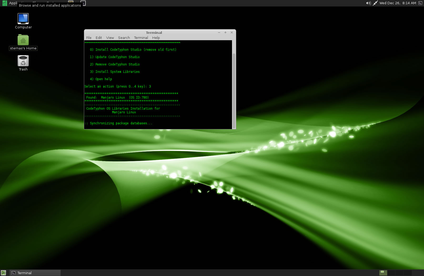

Is it possible to install CodeTyphon on Manajaro? 13 years 8 months ago #2957
Give us 1-2 hours to check this Sir
Manjaro Linux Mate 64 ?

Is it possible to install CodeTyphon on Manajaro? 13 years 8 months ago #2959
Try theses scripts
1) replace all Unix scripts in your installation folder (CodeTyphonIns)
with Unix scripts from attach zip file.
2) Install and Build CodeTyphon again.
Please Sir, report any problem here

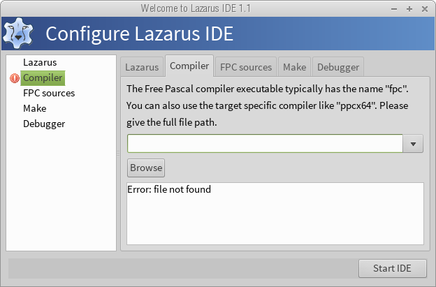

Is it possible to install CodeTyphon on Manajaro? 13 years 8 months ago #2960
  • reevil
  • reevil's Avatar Topic Author
  • Posts: 4
CodeTyphon was installed, but when I try to run Lazarus this windows pop up.
Last edit: by reevil.
Is it possible to install CodeTyphon on Manajaro? 13 years 8 months ago #2961
Try to run lazarus from CT Center as normal user (not root)
and run "IDE Settings Restore Default" from CT Center.
The following user(s) said Thank You: reevil
Is it possible to install CodeTyphon on Manajaro? 13 years 8 months ago #2962
  • reevil
  • Posts: 4
It works! Thank you very much, sir.
