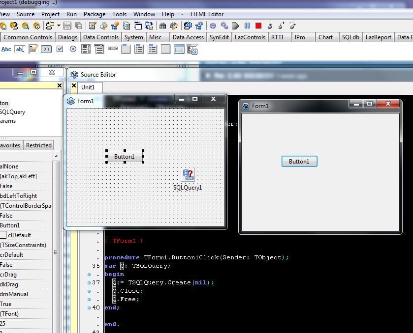

I did a simple test
var Q: TSQLQuery;
  Q:= TSQLQuery.Create(nil);
  Q.Close;
  Q.Free;
it can work properly on Original Lazarus (from Lazarus site) and raise an SIGSEGV exception on Code Typhon Lazarus 2.60.
So i conclude, that Code Typhon 2.60 is released with non stable Lazarus version. Then, i'm waiting for next version of Code Typhon...
altaifa.com
