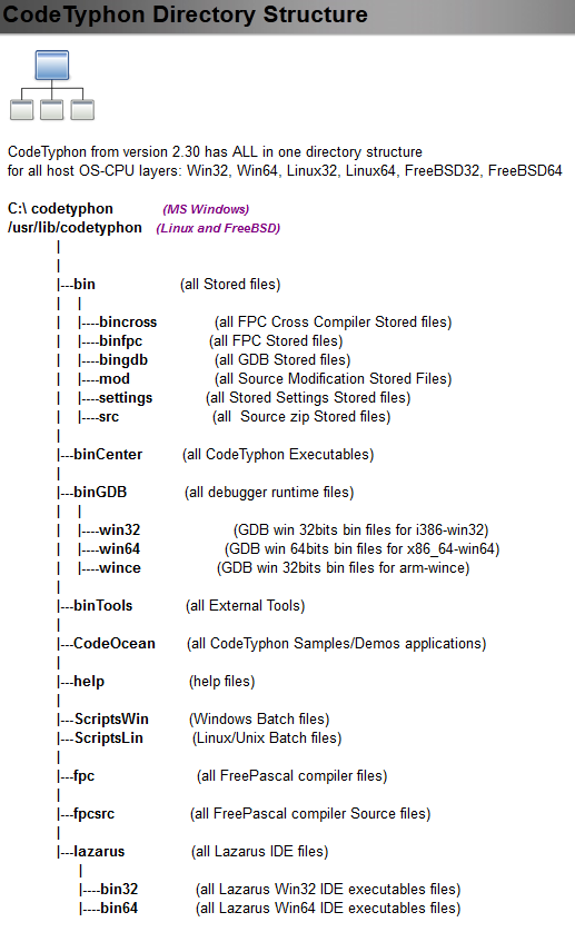

Re: Can I build CodeTyphon using Lazarus 1.30? 14 years 10 months ago #1361
And this is the new ver 2.30 CT directory
oh, new Lab version run OK and to ArchLinux 32/64
