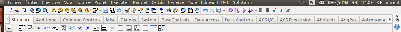

After installing package pl_vampyreimaging 6.4.1 on Typhon 6.5 32 bits with Ubuntu 16.04 LTS, i have no icons on main form of Typhon. I build Typhon with option "Normal IDE"
Before install package

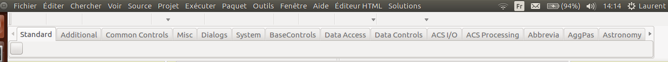

After install package and build Typhon
Attachment not found
After uninstalling the package, i have the icons OK.
Thanks.

Pb install pl_vampyreimaging 8 years 3 weeks ago #11845
  • Posts: 4630
  • Thank you received: 1141
pl_vampyreimaging package is NOT for IDE installation
To use it's simple add pl_vampyreimaging to your Projects Required Packages
In LAB CT 6.60 we have make some changes to pl_vampyreimaging pkg
