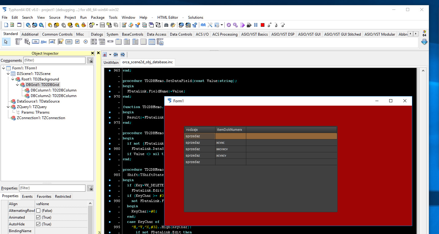

Hi!
1. Windows 10 Prof
2. CT 5.8
3. ZEOS components as data source from SQlite data base.
4. On form I put TD2Scene object, then TD2Background, and then TD2DBGrid.
5. I connect DBGrid to DataSource.
6. As far I don't create columns and connect them to the fields from DataSource, everything is fine.
But after connecting columns to fields, when I close application, it crashes.
greetings,
Marcin
Last edit: by Marcin W..

I've just realized that problem does not occur when the base is empty.
Sample data in attachment.

Problem with ORCA and DBGrid 9 years 10 months ago #10399
Guys
we "partial" fix the problem
Please TRY to Free TD2DBGrid before ZQuery1.close
procedure TForm1.FormClose(Sender: TObject; var CloseAction: TCloseAction);
  FreeAndNil(DBGrid1); // SOS Free TD2DBGrid before ZQuery1.close
  ZQuery1.Close;
In our tests (Win10-32 and Win10-64) work OK
PS: This sample is in Lab CT-CodeOcean now...
