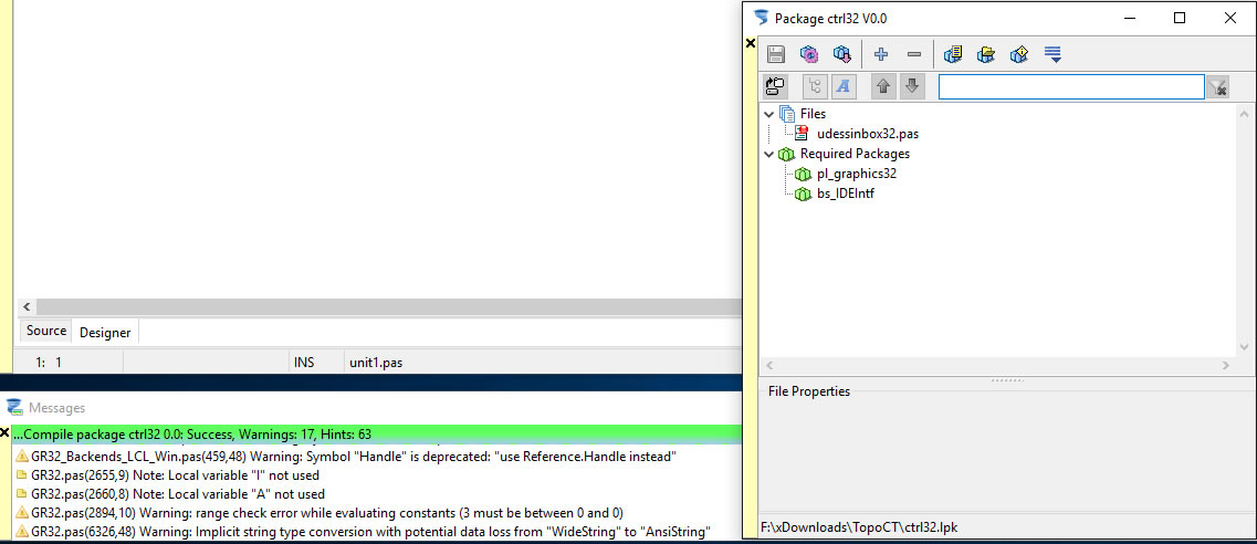

I want to create a component with TImage32 as ancestor.
When I compile it, there is an error with the message :
GR32_Brushes.pas(80,40) Error: Identifier not found "TCustomPolygonRenderer".
When i select the line where the error occurs, the editor find the declaration of TCustomPolygonRenderer in the unit GR32_Polygons.
So I don't understand why there is an error.
Than you for your answer

I send you the files that I had create. When i compile the package I have the message above :

I have found where I have made an error : I have put the package file in the folder of my application (H:\topo ct). If I put the file in the folder of Graphics32 (C:\codetyphon\typhon\components\pl_Graphics32) there is no more error.
Thank you for your answer
