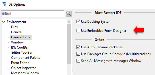

we know this problem but we can't solve it (yet)
My suggestion
stop using the Embedded Form Designer
for so big Width (4000)
Uncheck "Use Embedded Form Designer"

Sternas Stefanos wrote: Uncheck "Use Embedded Form Designer"
and restart Typhon IDE
Thank you for trying to help.
But this option is completely unacceptable, because the meaning of using IDE is lost.
The best option: in the design mode, set alNone and manually stretch the component to the size of the parent form, and in the runtime in OnFormCreate, set the value to alClient.
