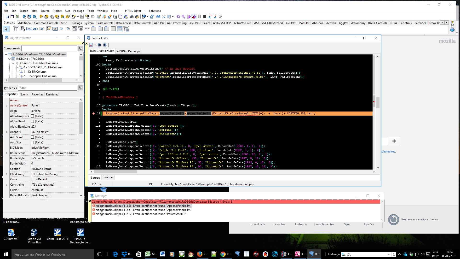

RxDbgrid - project example error Identifier not 10 years 3 months ago #9691
  • Francisco Carlos Rodrigues
  • Posts: 21
Hi
Os win 10
thanks
Francisco
RxDbgrid - project example error Identifier not 10 years 3 months ago #9692
  • Posts: 4637
Please Sir
add to last line of "USES" session
lazfileutils, LazUtf8 units
DBGrids, XMLPropStorage, types, lazfileutils, LazUtf8;
on changeslog.txt of LAB CT 5.8 we put this
WARNING  : Some File functions removed from "fileutil" unit
           If problem exist use "lazfileutils" and "LazUtf8" to uses session

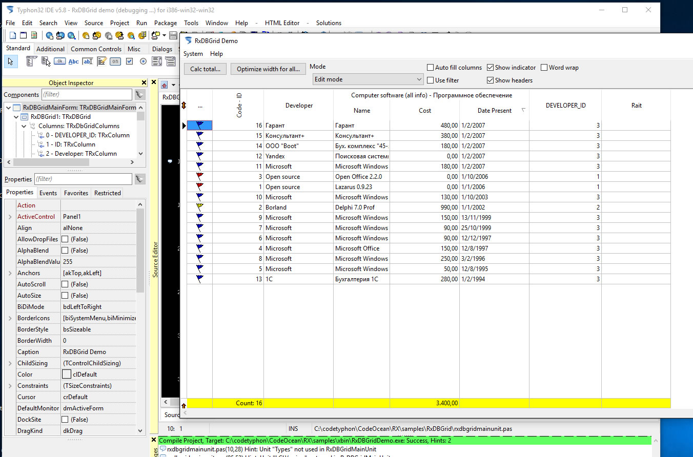

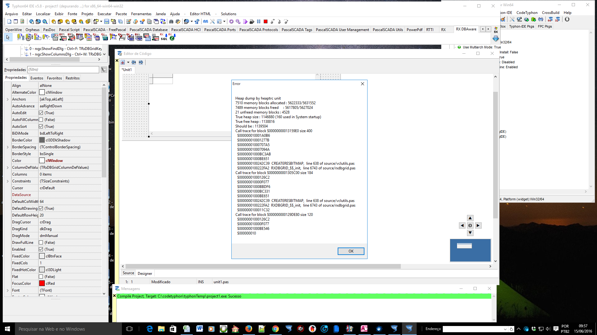

RxDbgrid - project example error Identifier not 10 years 3 months ago #9694
  • Posts: 21
Now compiling ok, but filter in data does not work.
I do not know if i'm doing something wrong.
If check memleaks i get this.
Thanks again

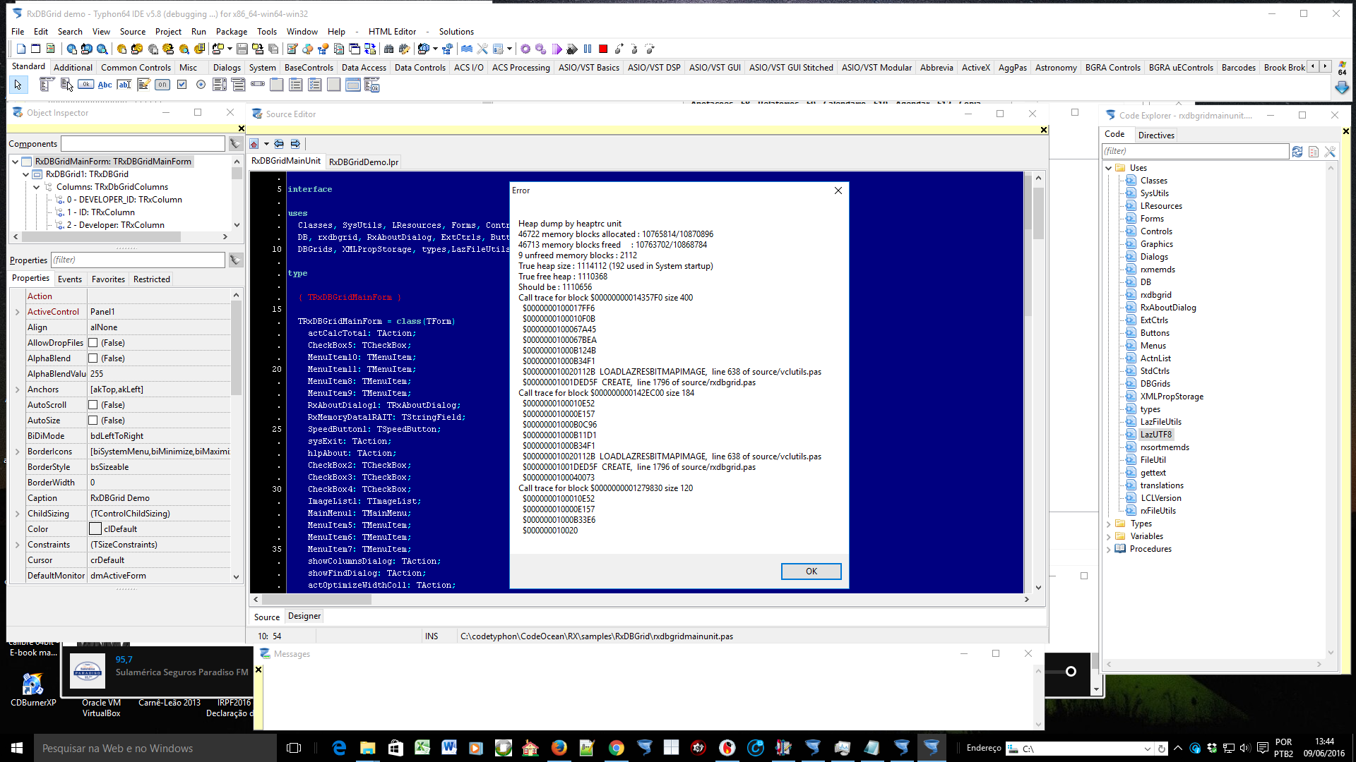

RxDbgrid - project example error Identifier not 10 years 3 months ago #9716
  • Posts: 21
I updated to ver 5.8.4.
I do not know why but i am getting memleaks and filter data does not clear filter.
