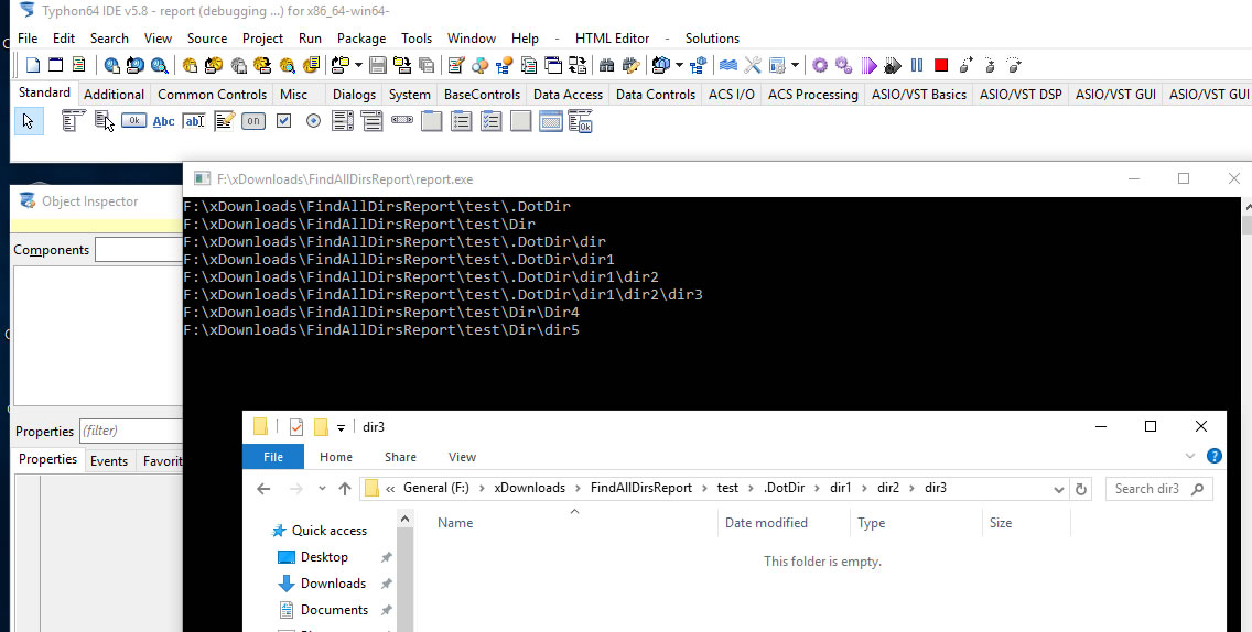

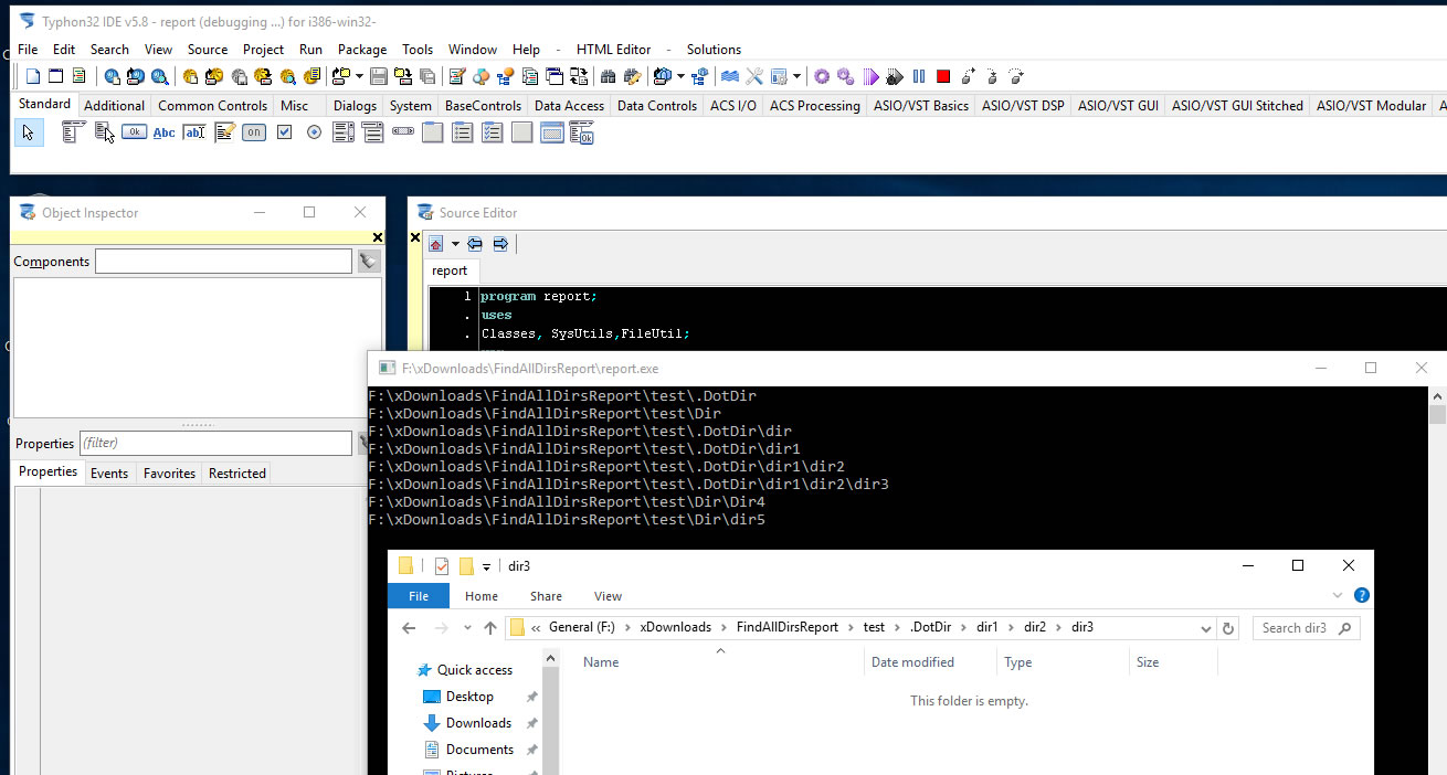

we test your project
-pic1 Typhon32
-pic2 Typhon64
Windows 10 Pro 64bits
