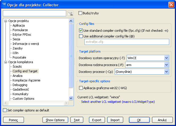

Options:
-T WInCE
- p arm
widgetset: wince

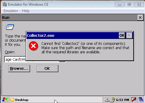

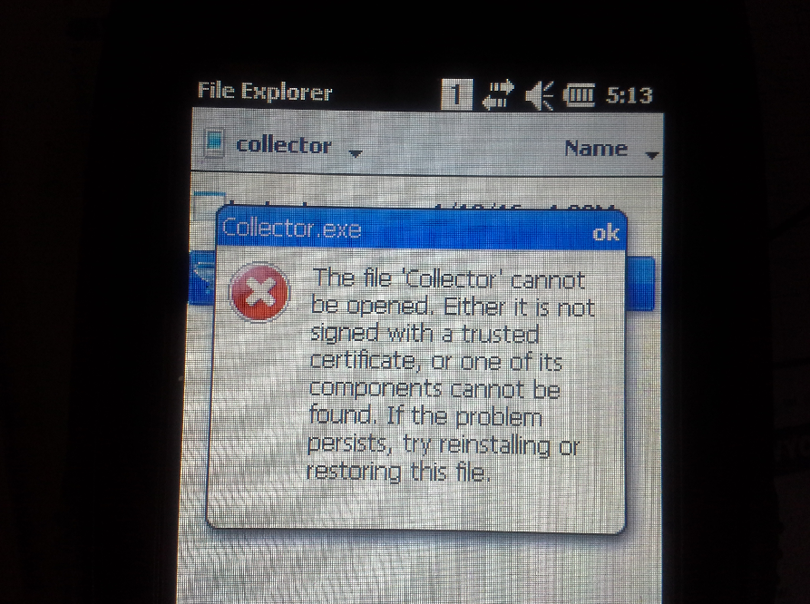

The project compiled but but it doesn't work on WinCE (error in attachment
it doesn't work even on WinCE emulator (error in attachment)
Compile options (in attachment)
What it can be?
May be I must copy some .dll to?
Last edit: by _13th_Dragon.

After remove VirtualTree program work on WinCE and on emulator.
So I am pretty sure - some .DLL need, am I right?
I can send this projekt to You if it can help You.
