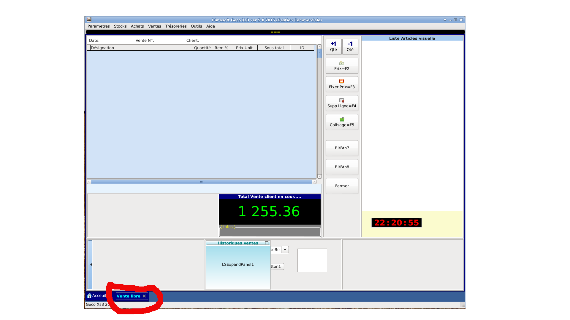

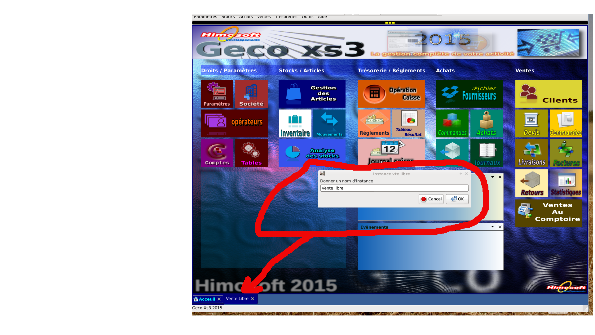

// Procedure qui ajoute une nouvelle page dans tpagecontrol //
// Maj le 07/10/2014 At 21:33 //
procedure TAcceuil.ButtonAddPage(Sender: TObject);
var NewTab : TTabSheet; //Déclaration du nouveau Tab
NewTab := TTabSheet.Create(PageAcceuil) ;
NewTab.PageControl := PageAcceuil;
NewTab.Caption := 'Nouvelle page';
NewTab.Caption:=InputBox('Ajout nouvelle page','Donner un nom de page', 'Nouvelle page');
PageAcceuil.ActivePage := NewTab;

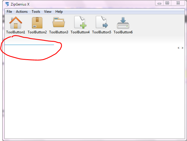

Dear Sternas, your solutions was right but I had to customize it a little bit.
In fact, while the first two mandatory lines of your sample have helped me adding a new tab, that tab looked a bit malformed: no styling, no caption, TFZPageControl menu not visible... (attachment #1)

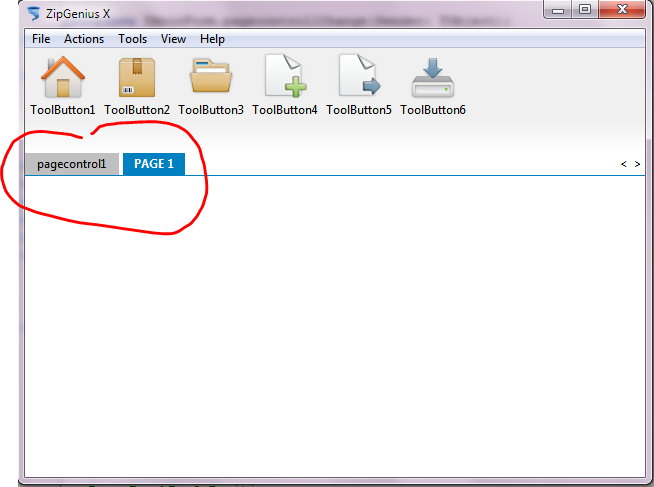

I had to dig a bit and found a good solution in "allfzregister.pas", where the code creates the extension for the properties editor where you can add pages at design time. In fact that creates good looking tabs and it helped me to find out how to add a page at runtime without messing up the layout. (attachment #2)
Here is my actual code:
procedure TMainForm.ToolButton2Click(Sender: TObject);
var
   myTab: TFZVirtualPage;
     myTab:=TFZVirtualPage.Create(pagecontrol1.Owner ); // specifying ".Owner" is MANDATORY.
     mytab.Caption :='aaaa';  // Don't know why but this line gets ignored....
     mytab.Align := alClient;
     myTab.parent:=pagecontrol1;
     mytab.Caption :='PAGE '+inttostr(pagecontrol1.PageCount); // and only this caption will be shown.
