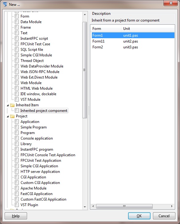

FYI:
I've just created an example project.
While it is possible to create a new Form which inherits from TForm1, it ist not possible to put a component on the newly created form ...
I tried it this way:
File-> new and then 'inherited item' and then 'inherited project component', selecting form1 (see screenshot)
I'm quite puzzled ...

Ok, i found it in the Lazarus-Bugtracker
This is a Bug (Bug-ID 0025084 in the Mantis-Bugtracker), but fixed in Lazarus-Revision 42945!
Has anyone an idea how to get this revision (or newer, actually) into the current codetyphon-version ??
Just copying the lazarus-sources in the typhon-directory and then compiling?
placing a component (TPanel e.g) on a derived Form 12 years 11 months ago #4610
You must wait for CT ver 4.6 Sir
The following user(s) said Thank You: zeljko, Adular
