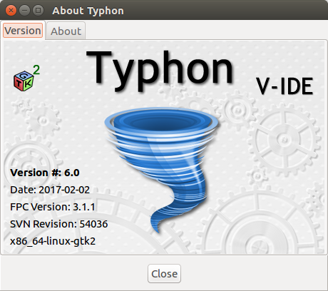

Hi Sternas, thanks for looking into this. I am using v6.00 with GTK2, hosted by Ubuntu 16.04 64bits, is there a patch I can apply to my current setup? Attached is an 'about' screen dump.
Many thanks,
Chor
