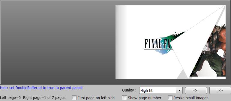

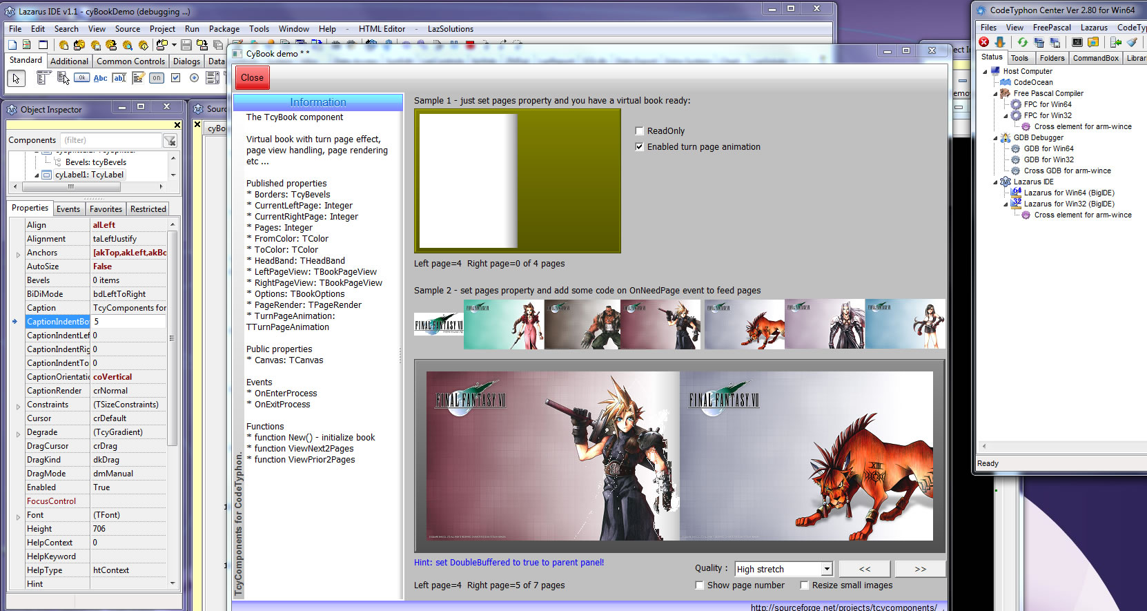

Cindy v5.03 released!
Added TcyBook component:
https://sourceforge.net/projects/tcycomponents/screenshots/328505
Virtual book with turn page effect (perfect for android devices), page rendering etc ...
Also added TcyBook and TcyDebug demo.
Mauricio

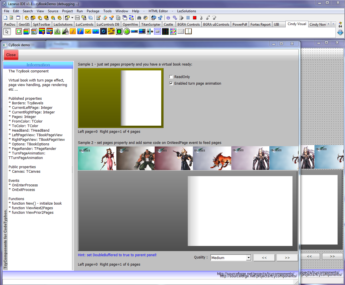

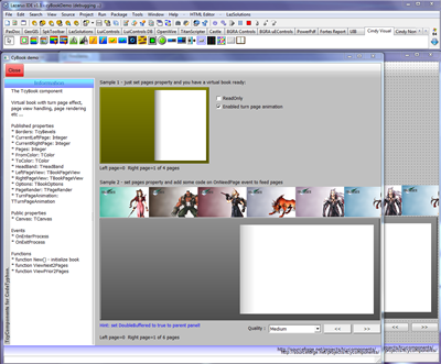

[LAB] Cindy components 14 years 3 months ago #2233
We port ver 5.0.3 on windows
now we must solve some graphic problems (cyGraphics.pas)
more news later...
and large image

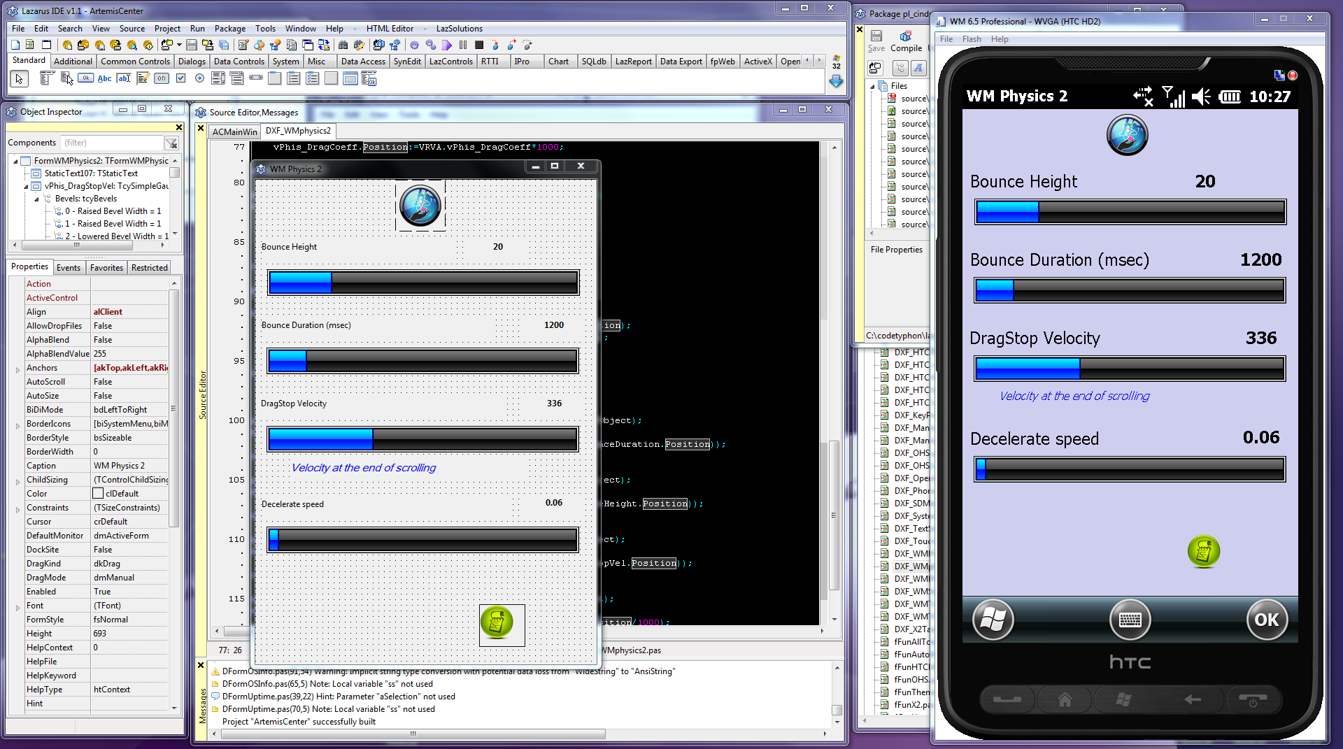

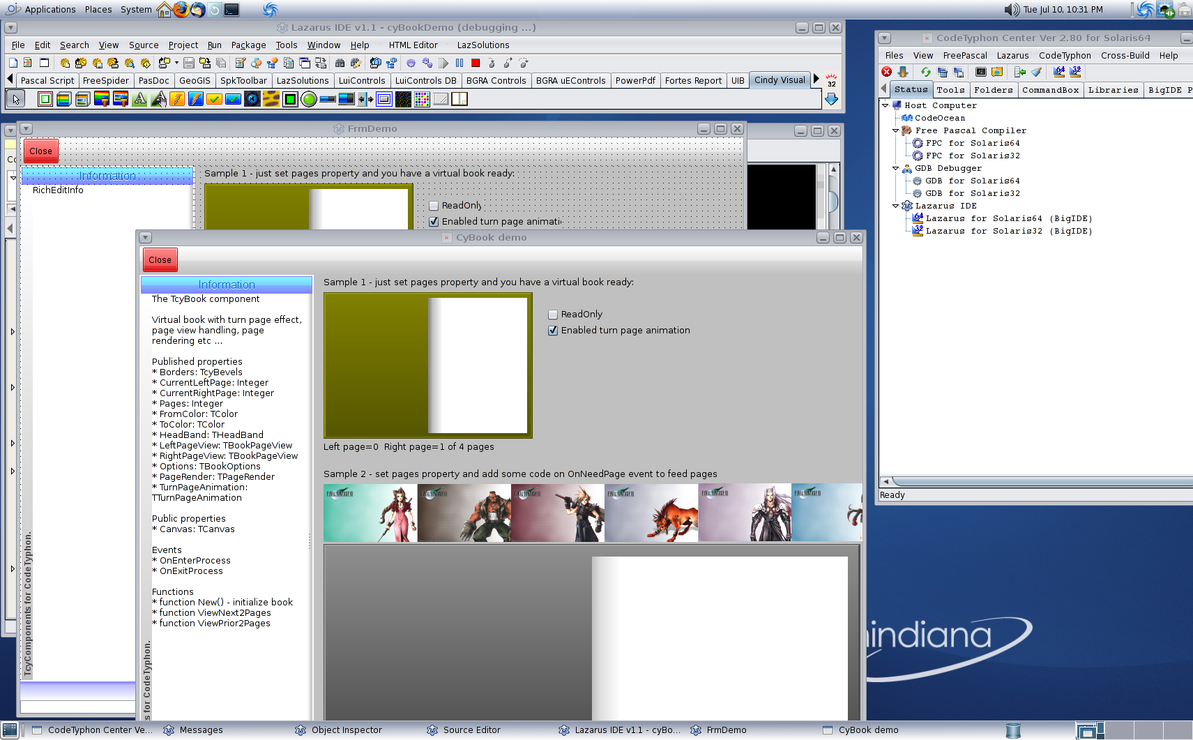

[LAB] Cindy components 14 years 3 months ago #2234
Port of ver 5.0.3 on Wince finish
(CodeTyphon crossbuild Ability)
Emulator with Windows Mobile 6.5.3
and big image

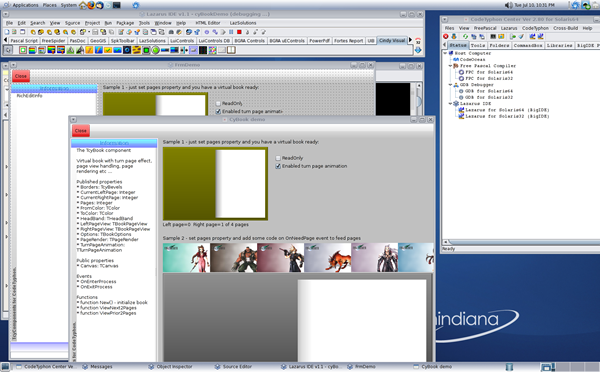

[LAB] Cindy components 14 years 3 months ago #2235
Port of ver 5.0.3 on Solaris/OpenIndiana 64 finish
CodeTyphon Studio Power...
tomorrow Linux and FreeBSD ports
and big image
