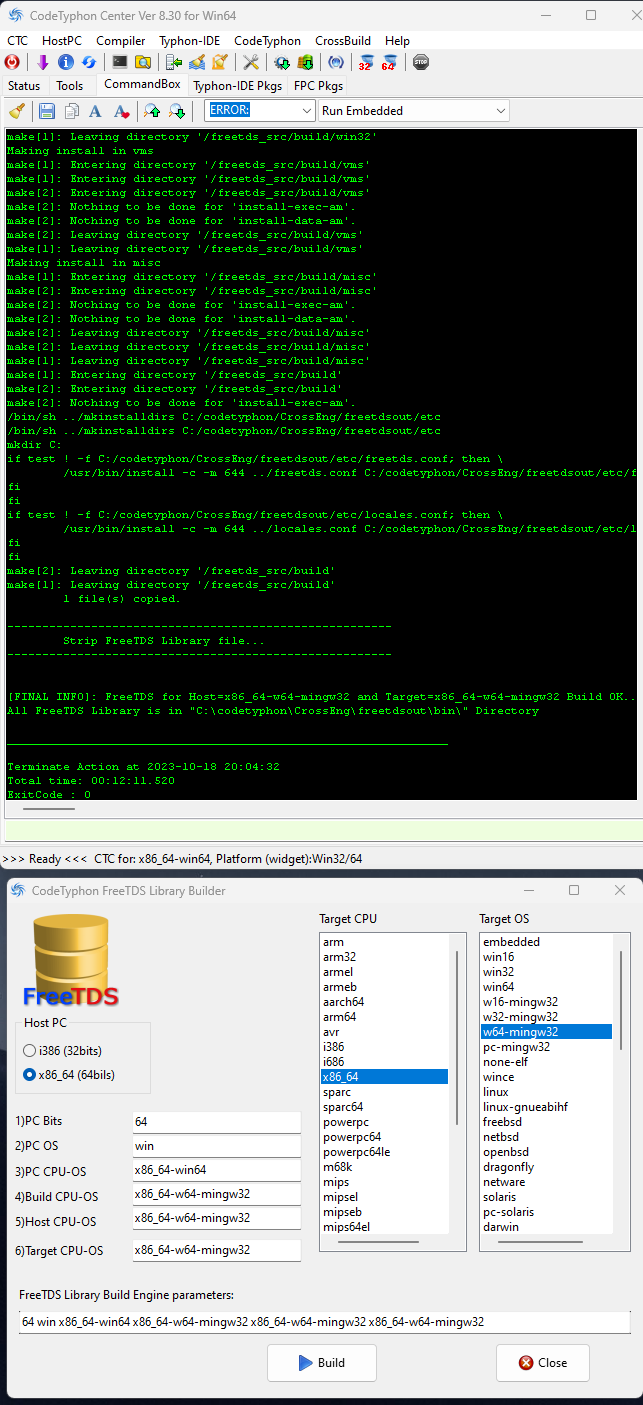

It's NOT simple task
-First we check FreeTDS libraries
Old FreeTDS library dblib.dll not exist in the latest FreeTDS version 1.4.3
Latest FreeTDS library has :
-libct-4.dll
-libsybdb-5.dll
-libtdsodbc-0.dll
We check the Functions in these Files and we found that libsybdb-5.dll is the old dblib.dll
New libsybdb-5.dll need many GNU libraries to work correct:
-gcc-libs
-libiconv
-openssl
Our solution is to ADD at CTCenter => FreeTDS builder
and "Static" build FreeTDS from sources.
We must Build with CTCenter FreeTDS libraries
We must test these libraries...
You can test the new libsybdb-5.dll => Rename to dblib.dll
from attach file, is 64Bit
And a screen from Our FreeTDS builds...
Sir, this is RealTime support,
from most Powerful Progamming Studio on the Planet...

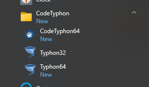

It looks like I don't have this CT Center
This is all I have got under the CT menu
Last edit: by Guido.

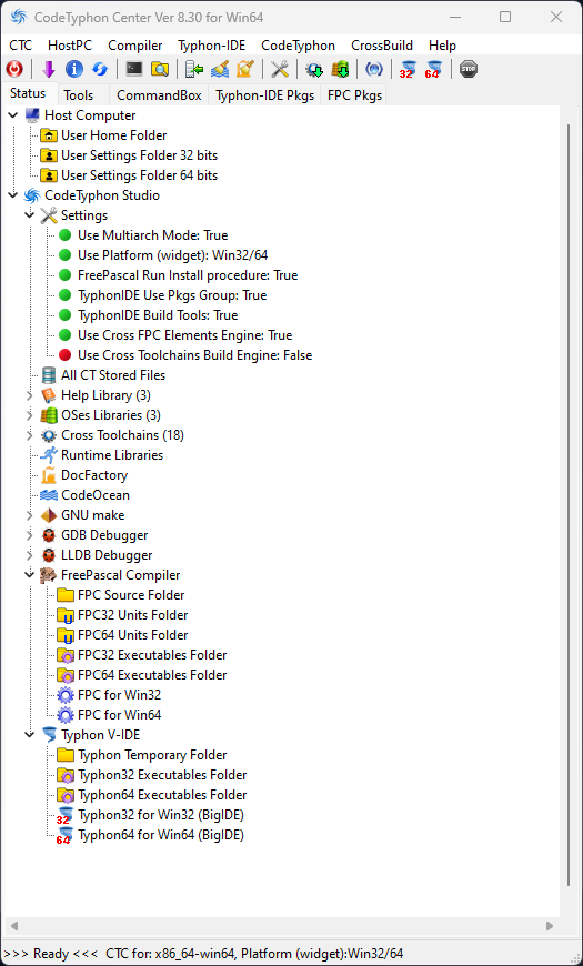

very old bug still not fixed 2 years 11 months ago #18091
  • Posts: 1434
  • Thank you received: 230
CodeTyphon64
In NEXT LAB CT release,
FreeTDS library for windows is in:
C:\codetyphon\binRuntimes\x86_64-win64 and
C:\codetyphon\binRuntimes\i386-win32
and
CT Center will have this menu....
very old bug still not fixed 2 years 11 months ago #18093
  • Guido
  • Guido's Avatar Topic Author
  • Posts: 16
OK I found the CT Center, now what is the next step ? How do I do this freeTDS from there ?
