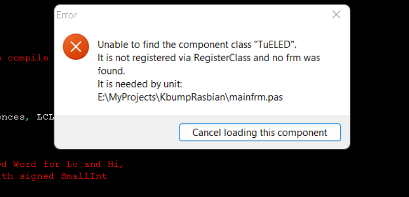

I n one of my projects that i created with a previous version of typhon i have an ueled component , now when I try to open this project i gives me an error that it cant find the teuled class, I searched the web and found the package for free pascal, my question is how do I get this package installed in typhon. When i try package links it doe not give me the option to create links only update links and click it does nothing, thank you. I have attached 7zipped file with these components.

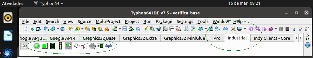

See the Industrial pallete. The required packed is lz_industrial (see your project inspector and add)

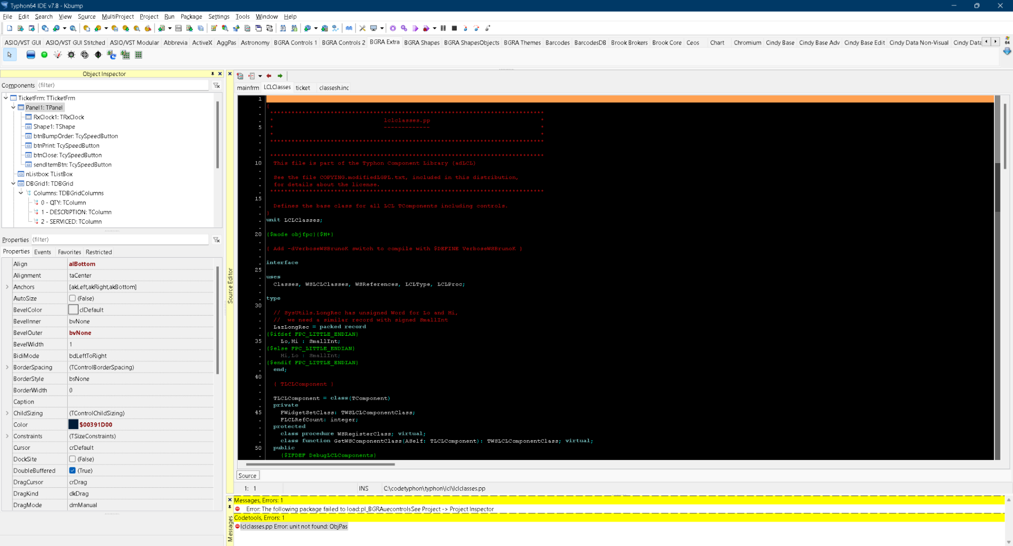

I do have pl_BGRAextra package installed but my problem is that the application's main form has tueled component on the form  which cause the error and when I click on the main.frm file I get the error, the form designer does not load. Therefore i cannot delete the component. I am attaching the a pictures to that affect.
