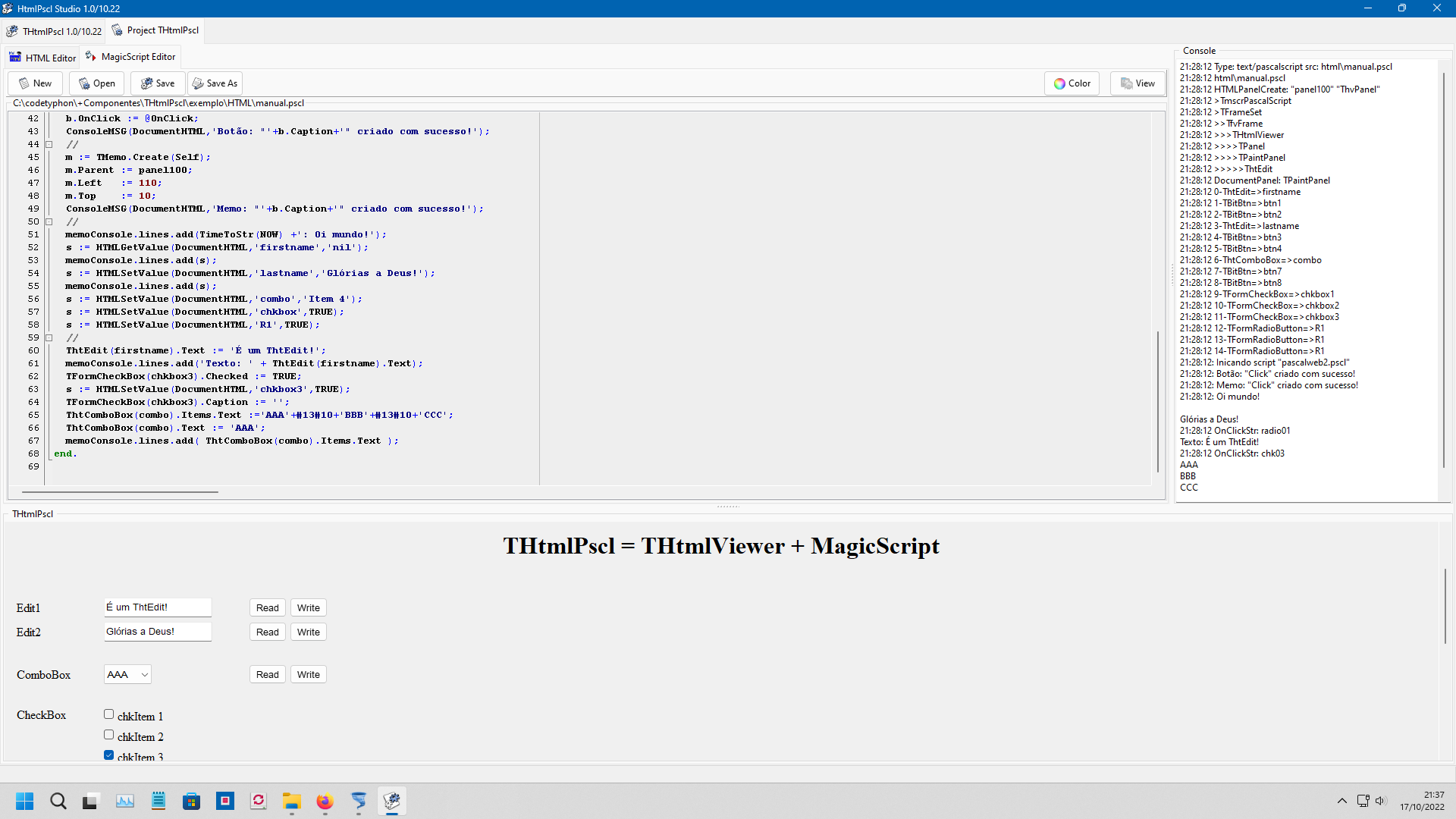

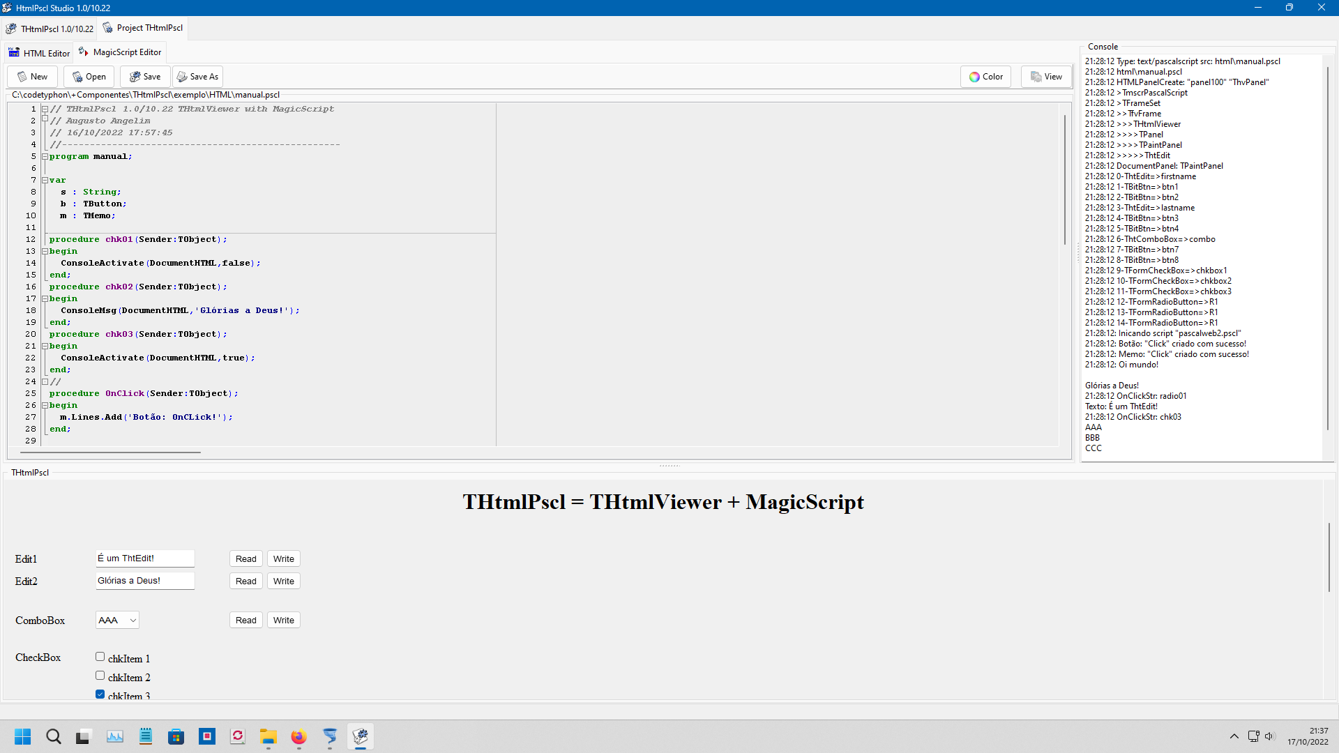

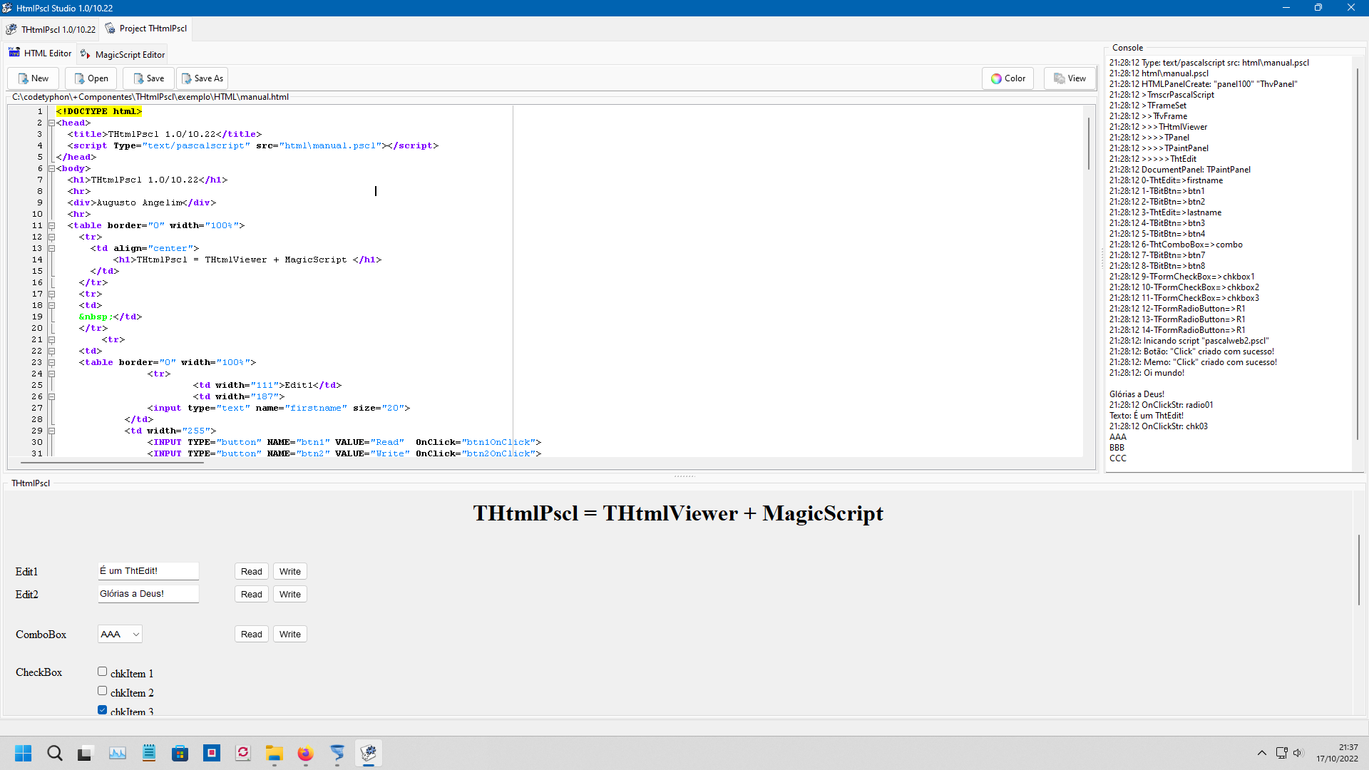

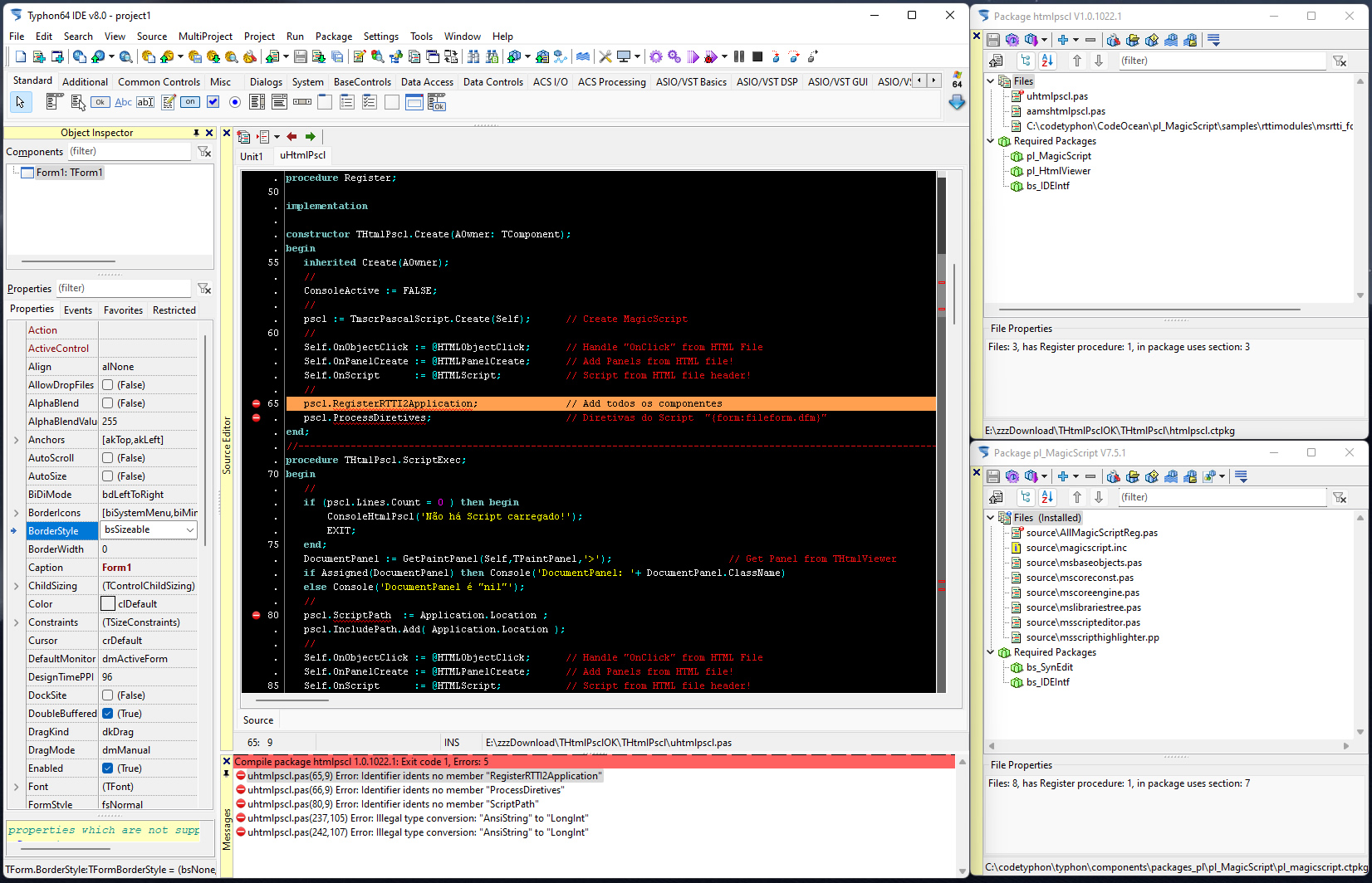

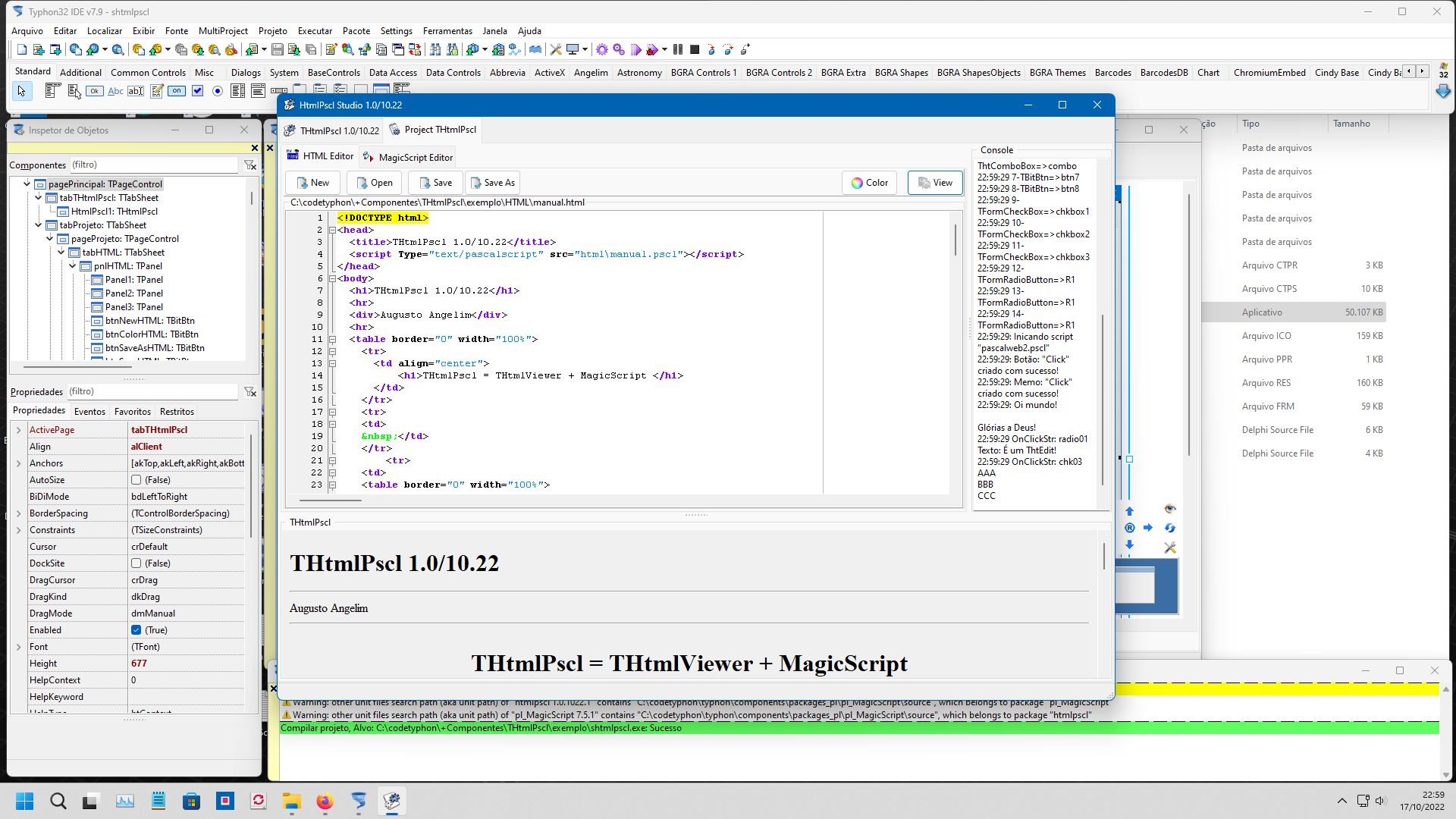

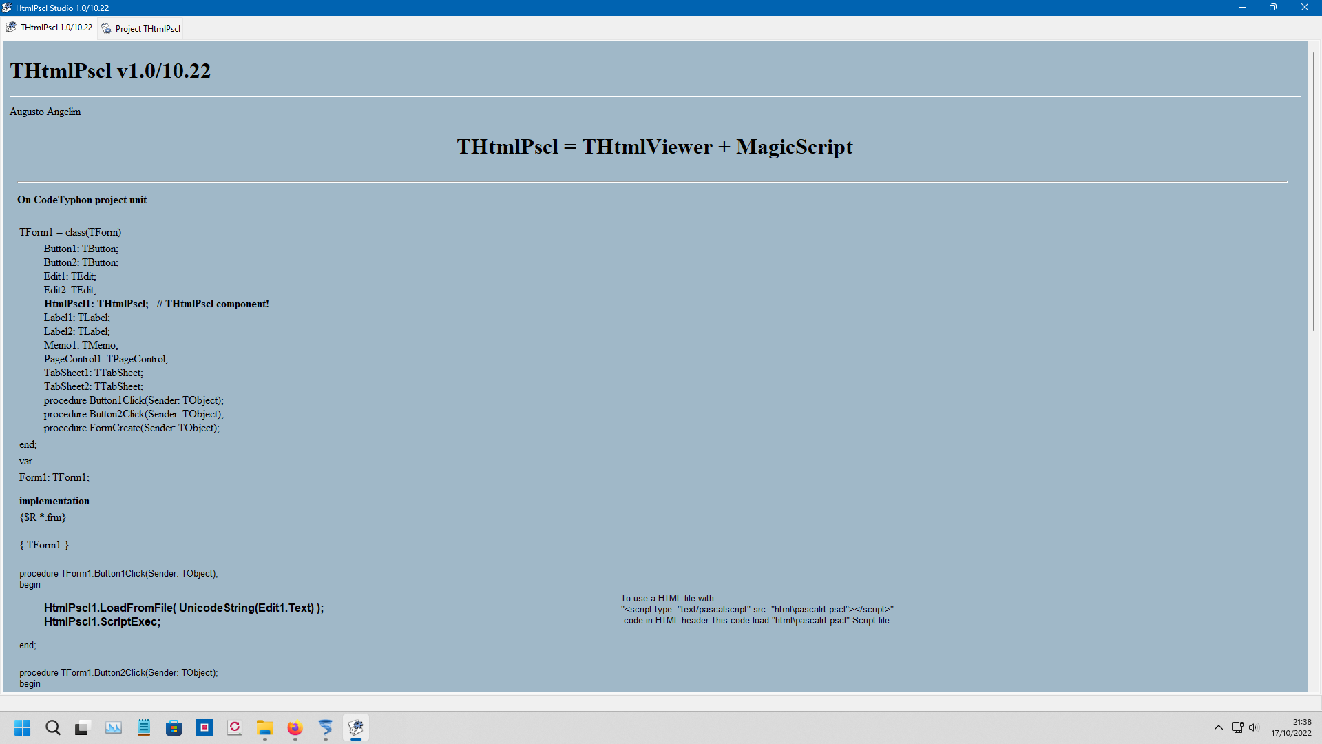

Hey,
This is the first version of the component that binds THtmlViewer + MagicScript
Lets you run a pascal script when loading an HTML page!
Easy to use!
It comes with a small manual and an example project of use of the "suite" type.
New component: THtmlPscl = THtmlViewer + MagicScript (best Pascal Script) 4 years 1 month ago #17348
some functions are missing, we can't build the pkg.

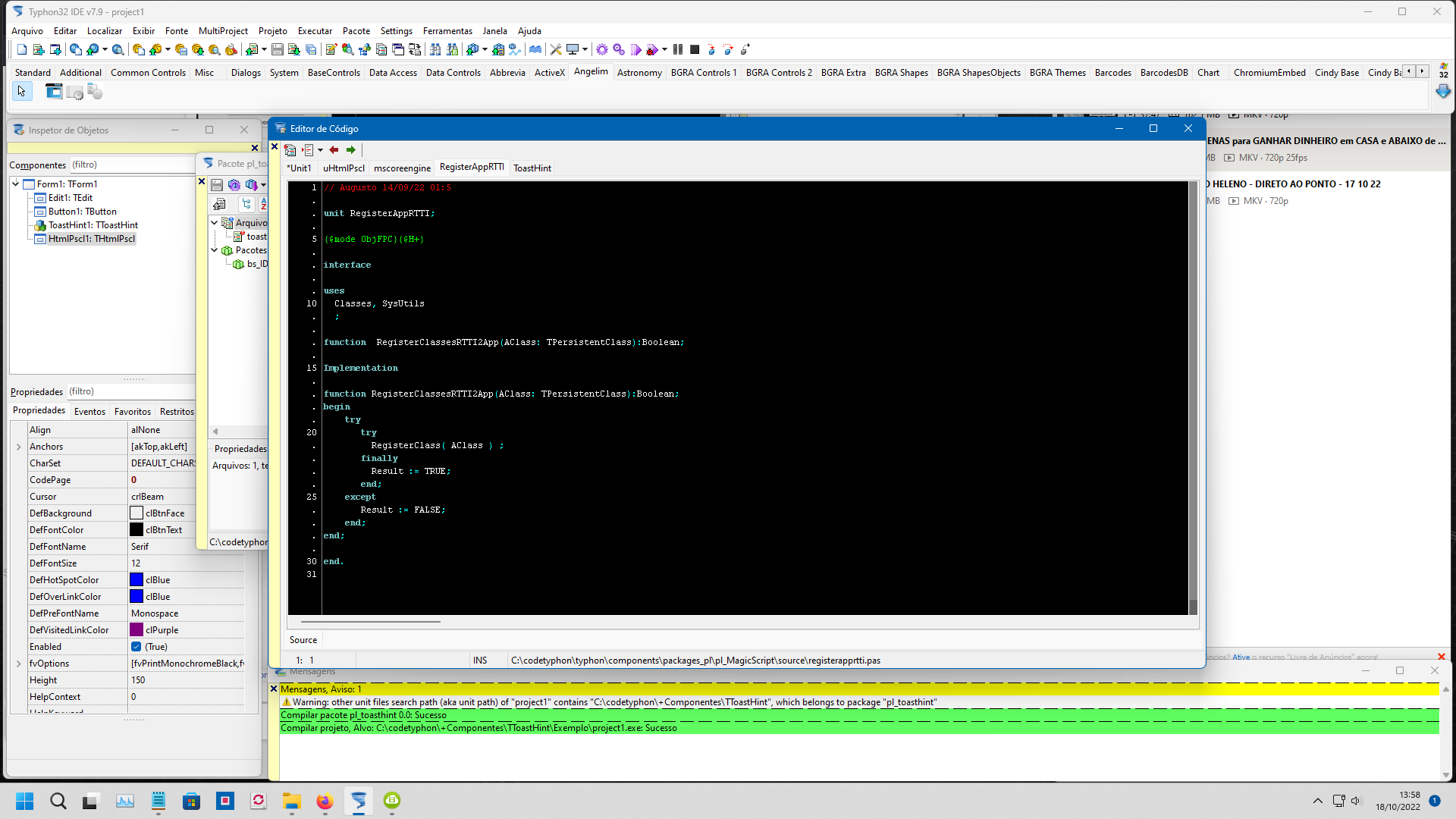

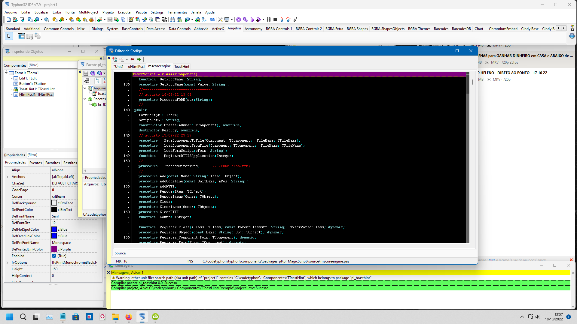

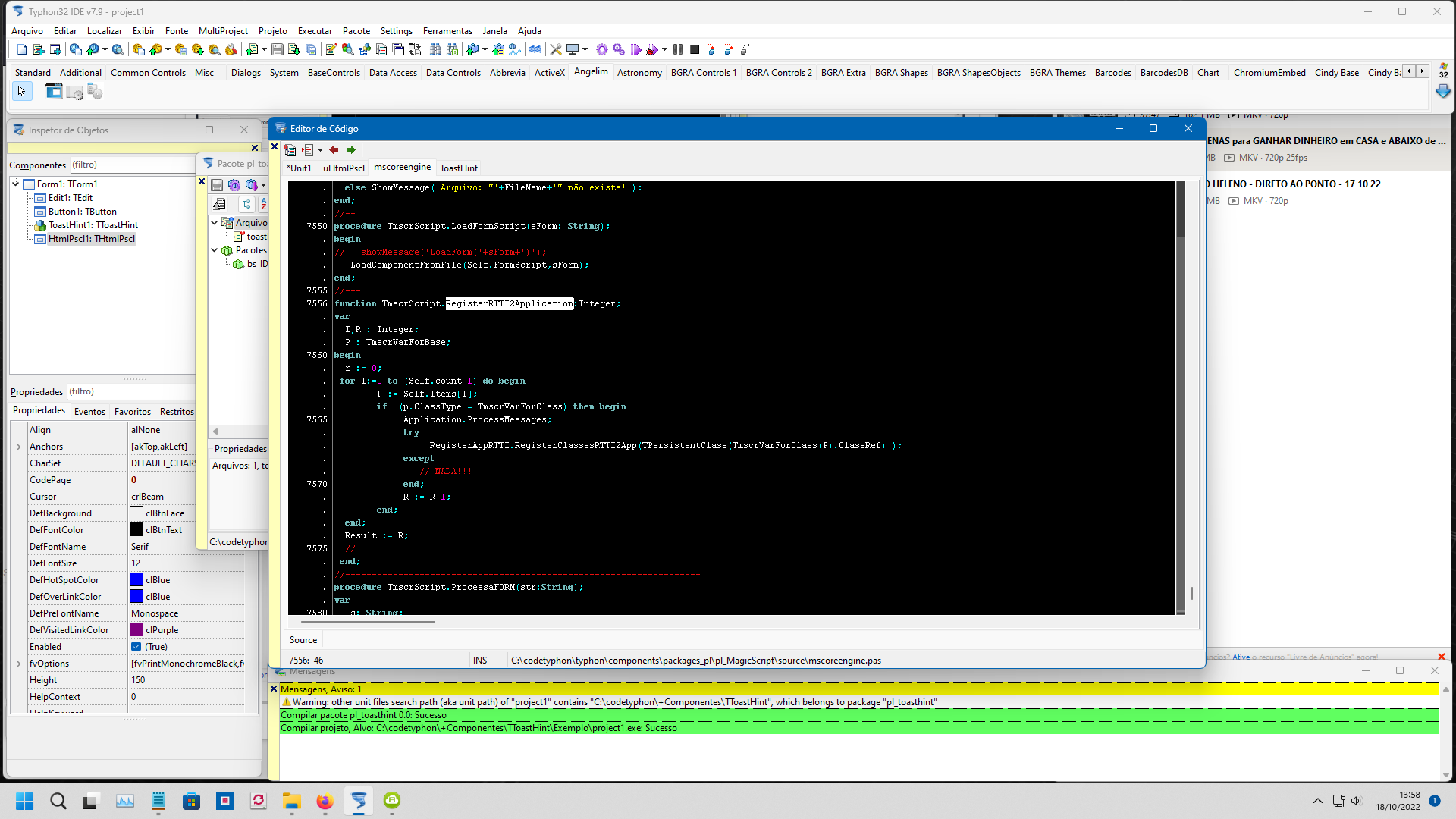

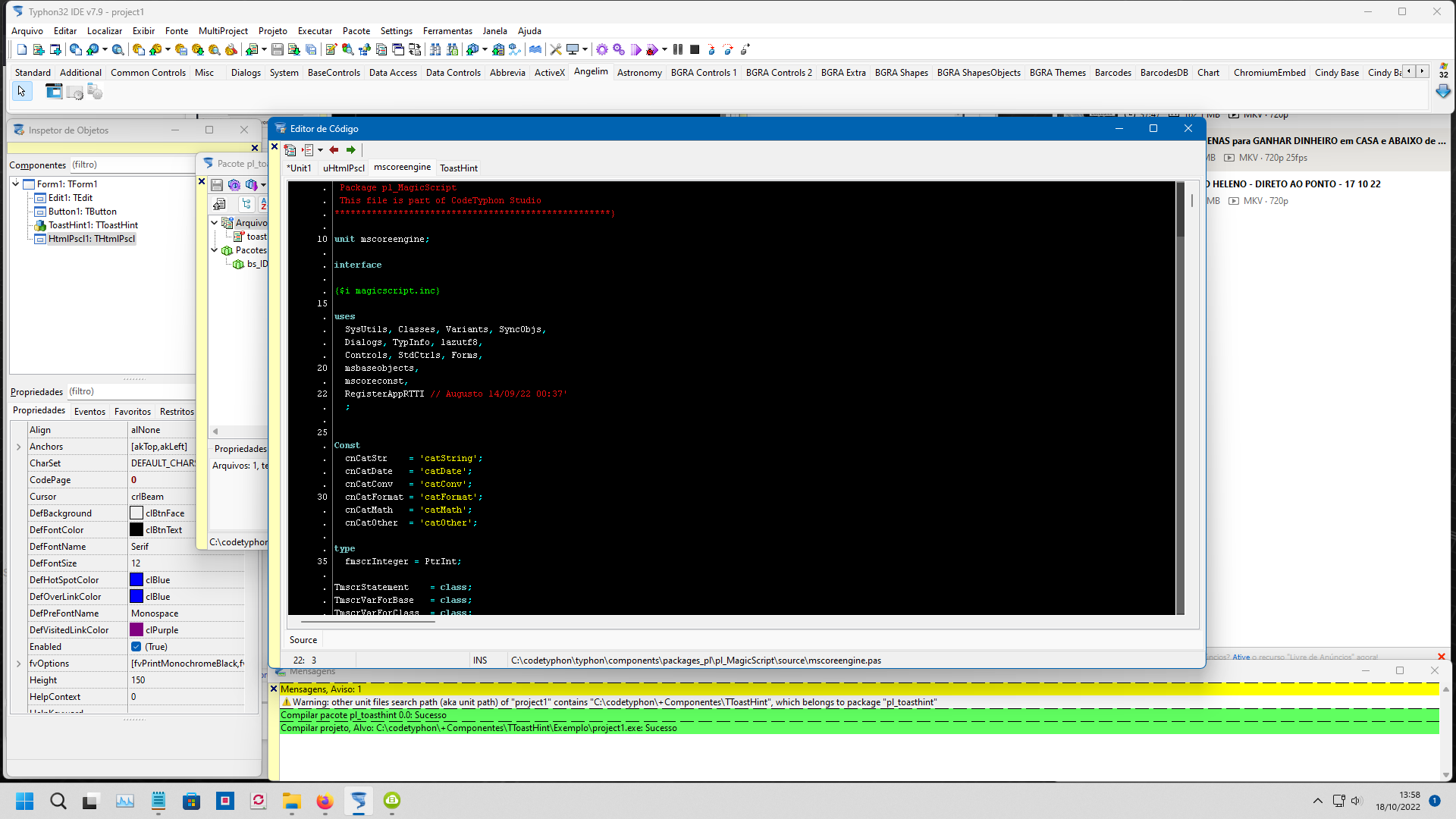

Forgive me!
Forgot to mention that I modified Magic Script to load "frm" and automatically load all classes registered in RTTI!
I Will send sources!
The project that loads "frm" in MagicScript is in testing!
Lke this:
