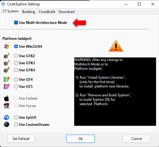

Go to
CTCenter=>CodeTyphon=>Settings
Check "Use Multi-Architecture Mode"
If this NOT work, check your PC OS installation for problems
