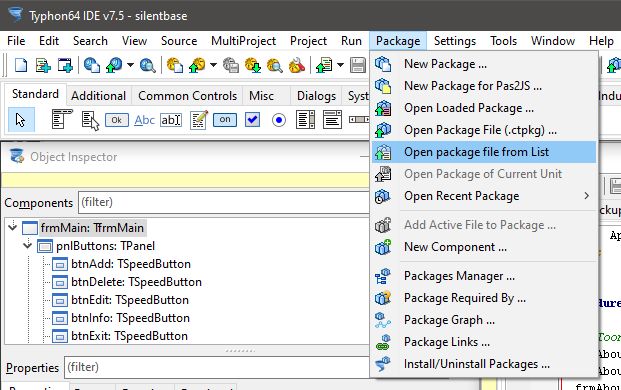

Go to the Package menu and select "Open package from List", then select PL_ZEOSDBO (see attached screenshot).
In the window that appears then first select Compile to compile the package and then click the button next to the Compile button to install the package.
When questioned to rebuild Typhon click Yes and after the restart the ZEOS package will be available to you.

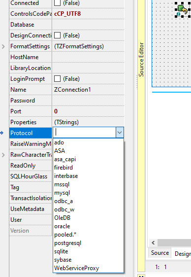

Another question, i install the Typhon64 in the last week, but not seems that have the last Zeos library installed in it. Notoriously, the Zeos ODBC and the Zeos ADO dont appears in the IDE. I repeat my request if you can tell me how to proceed to install the Zeos package in the IDE.

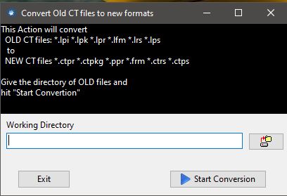

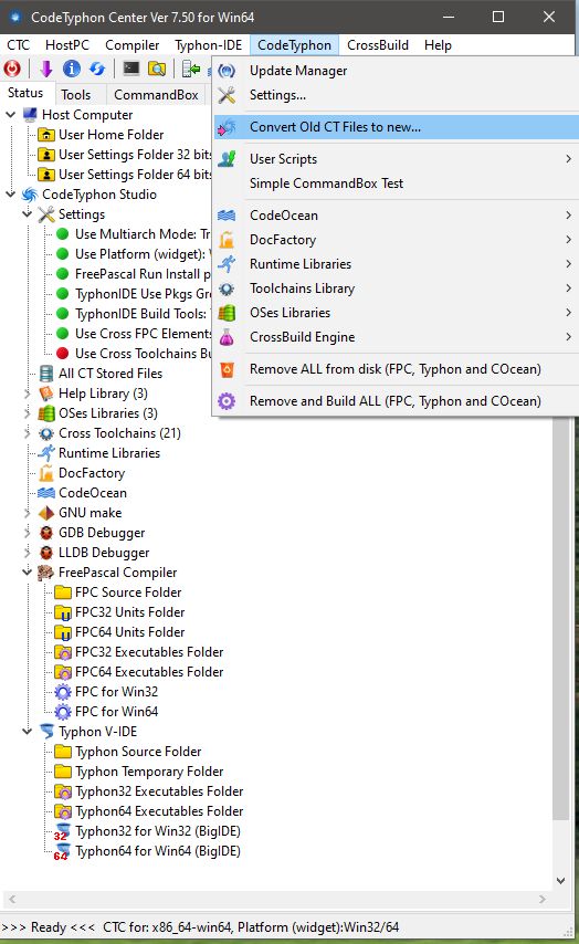

Start the CodeTyphon Center and select the "CodeTyphon" menu, in that menu choose "Convert old CT files to new" (see attached screenshot Typhon2.jpg).
In the new window select the folder you unpacked the Lazarus ZEOS package and click the "Start Conversion" button. (see attached screenshot Typhon3.jpg
After that you can install the converted package just as I described before.
