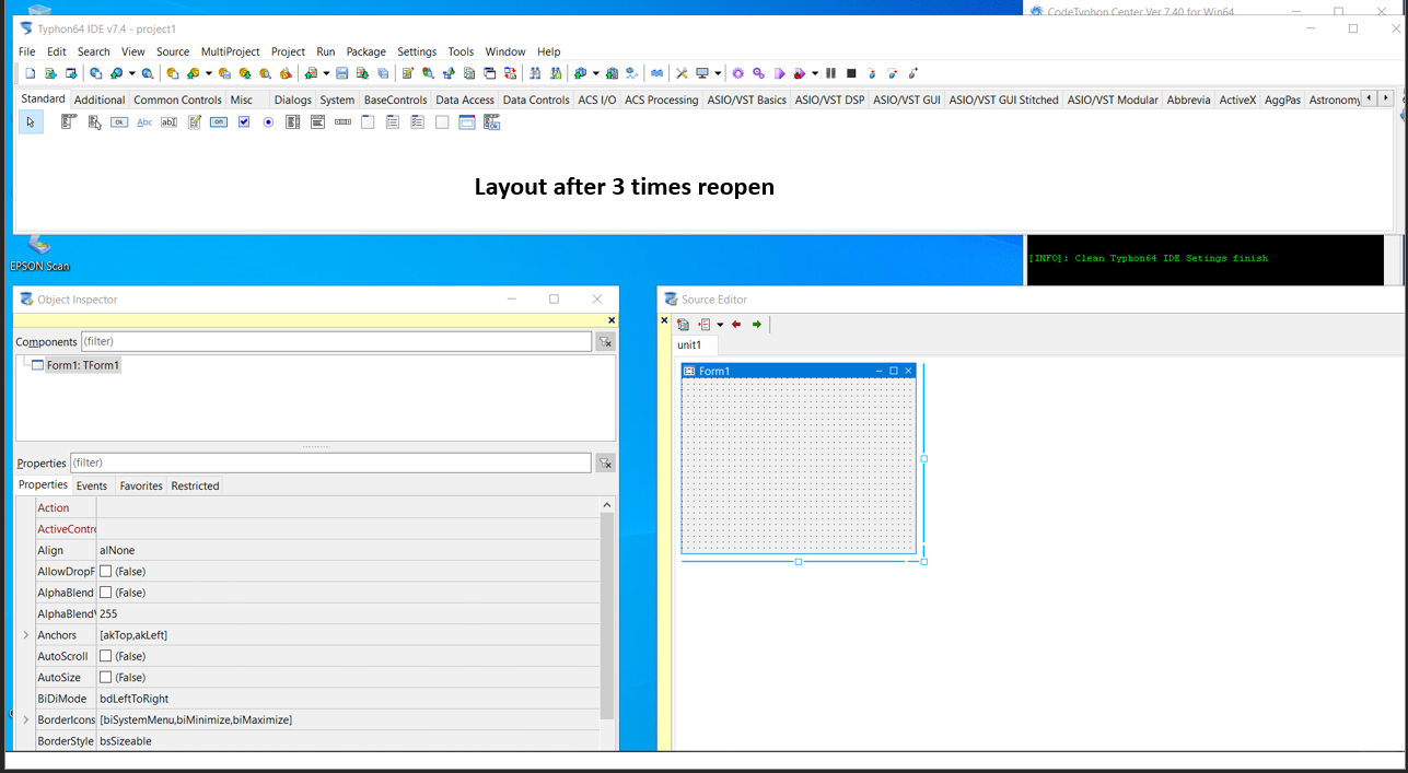

Hello Sir,
Just downloaded and installed CT ver. 7.40 and then restore default layout all docked found error. Every time I closed the application and reopen it, the layout always changes.
Please advice my problem.
Thanks in advance

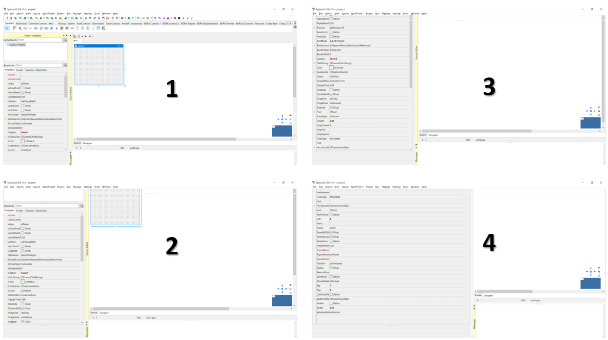

Hi Sir,
I can confirm that error on windows 10 64 bit build 2004
When ide all docked option is selected, then ide is docked noraml. But when i close ide then reopen it then picture 2 by seagate is the posotion of ide. Form goes to above at the place of toolbar. This never happened in 7.3.

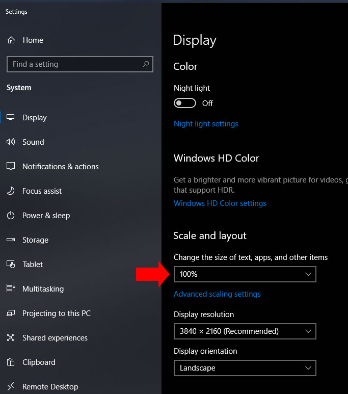

CT 7.40 IDE Error 5 years 3 months ago #15866
  • Posts: 4635
This very strange
Your PC "Scale and layout factor" ?
CT 7.40 IDE Error 5 years 3 months ago #15867
  • Posts: 4635
I think we found the problem
