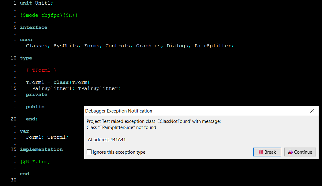

I'am using version 7.3 and i have got an error Class "TPairSplitterSide" Not Found, please advice my problem.

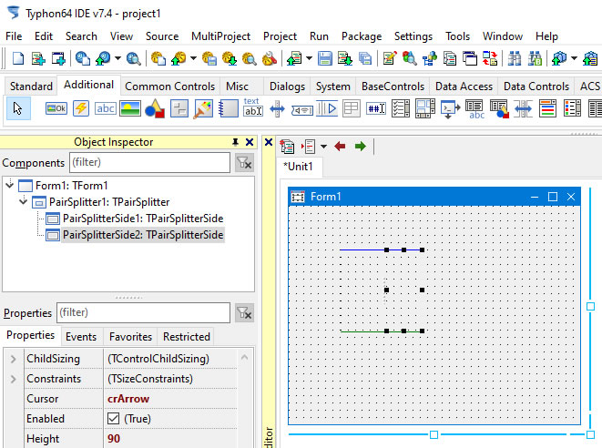

Go to "Additional" componets page
and add to a form a TPairSplitter comp
The IDE write this code
uses
  Classes, SysUtils, Forms, Controls, Graphics, Dialogs, PairSplitter;
type
  { TForm1 }
  TForm1 = class(TForm)
    PairSplitter1: TPairSplitter;
    PairSplitterSide1: TPairSplitterSide;
    PairSplitterSide2: TPairSplitterSide;
  private
TPairSplitter without 2xTPairSplitterSide1 can't exists

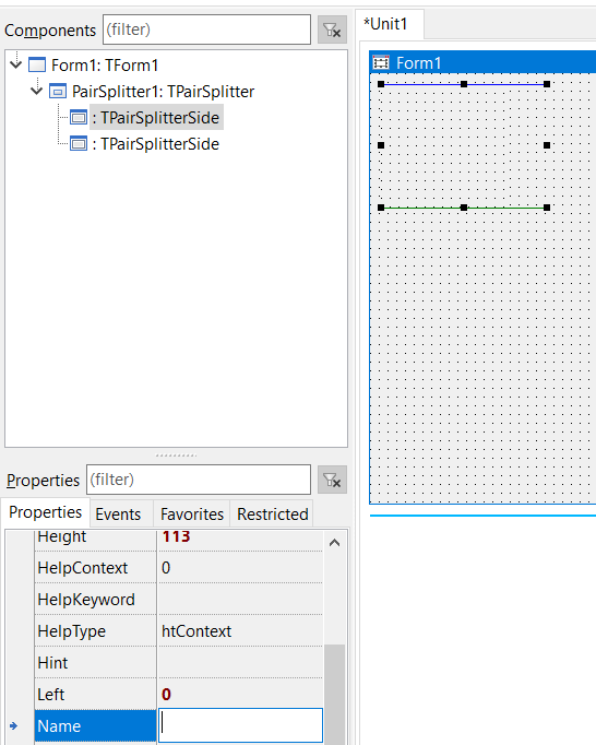

Actually I've done the steps as you suggest, unfortunately the IDE didn't write down like your script. Anda then when I looked at the property name of TPairSplitterSide still empty
But by copying your script my problem is solved
