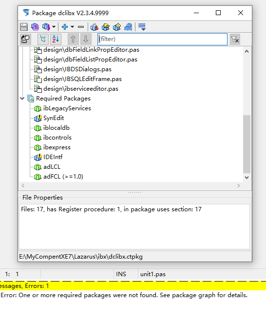

Hello, happy new year !
i want to install   IBX 2.3.4 for Lazarus ,but failure!
mwasoftware.co.uk/ibx
i want to use the component because my program port from delphi.
see the note image
thanks

how to install IBX 2.3.3 for Lazarus 5 years 10 months ago #15438
  • Posts: 4639
Replece
IDEIntf   => bs_IDEIntf
SynEdit => lz_SynEdit or lz_SynEditDsgn

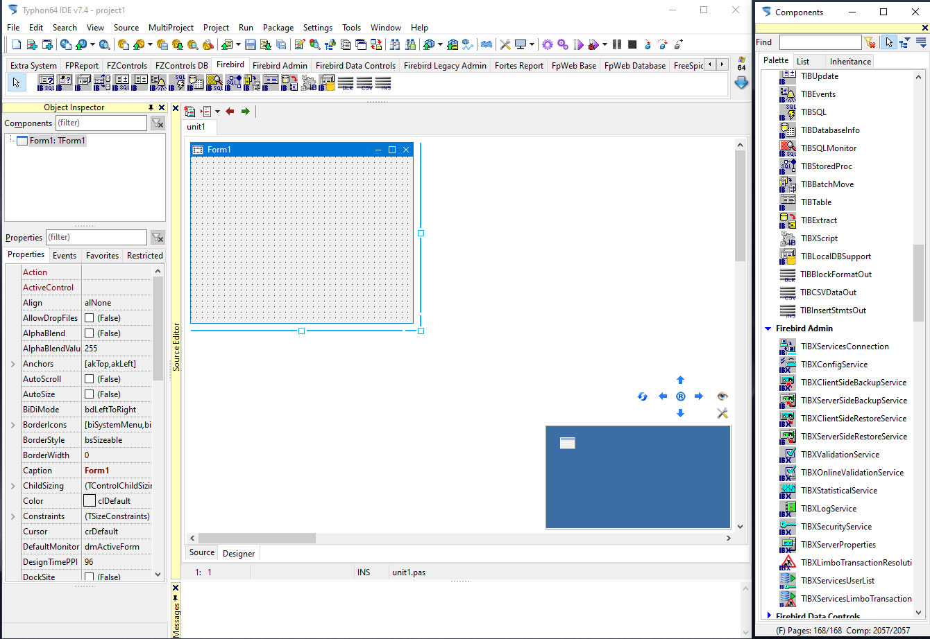

how to install IBX 2.3.3 for Lazarus 5 years 9 months ago #15484
  • Posts: 4639
We start IBX port to LAB CT (pl_FirebirdDB pkg)
but need more tests...
The following user(s) said Thank You: bibsi
