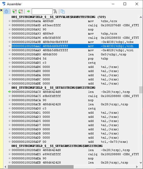

Question about window of debugger 6 years 10 months ago #13998
  • superc
  • Posts: 75
my version of CT is Typhon 6.9 r61812 FPC 3.3.1 r42912 Platform : x86_64-win64-win32/win64
with this code:
       if not mdb.Active then
        mdb.Active:= true;
      TMemDataset(mdb).Append;
      TMemDataset(mdb).FieldByName('batch').AsVariant:= batch;
      TMemDataset(mdb).FieldByName('codVal').AsVariant:= va;
      TMemDataset(mdb).FieldByName('codTop').AsVariant:= vb;
      TMemDataset(mdb).Post;
      OutcodArt:= tempArt;
      Result := True;
works fine but when build I receive a warning :
Call to subroutine "operator :=(const source:Variant):AnsiString;" marked as inline is not inlined
If modify code as:
      TMemDataset(mdb).FieldByName('batch').AsString:= batch;
      TMemDataset(mdb).FieldByName('codVal').AsString:= va;
      TMemDataset(mdb).FieldByName('codTop').AsString:= vb;
When debug a window similar to the one in the photo opens
In both case the program run correctly, but
in previous versions of CodeTyphon I didn't have a similar behavior, because now yes?

Question about window of debugger 6 years 10 months ago #14001
  • Peter Heckert
  • Peter Heckert's Avatar
Please look again to the message window. It should say "Note", not "Warning".
This should not give a "warning" but an informational "Note". It says the compiler decided not to inline a routine that was marked as "inline" in sourcecode.
Instead inlining the routine is called as subroutine. This is harmless.
Under some circumstances the assembly window pops up. This has (probably) nothing to do with inlining or not inlining. It happens while singlestepping.
It seems to me, this happens when RTL routines are hit, that are compiled without debug information.
This is my observation, I do not know if this is the final truth.
The assembly window pops up also in lazarus, when a compiler version > 3.0.4 is used. Possibly the debug information in newer compilers is different and GDB or Lazarus doesnt fully understand it.
This is, what I think about it, not what I know.
Addendum:
Possibly this happens when a RTL-routine is inlined, that has no debug information and we step over it?
This is just an unproven quick hypothetic idea, I hopefully can try to test it. But first I happily install LAB 7.0.
Last edit: by Peter Heckert.

Question about window of debugger 6 years 10 months ago #14005
  • Peter Heckert
You cited this message:
"Call to subroutine "operator :=(const source:Variant):AnsiString;" marked as inline is not inlined"
This means somewhere in the fpc runtime library there is an operator ":=" and this has the attribute "inline", this means, the compiler should not call the code of this operator, but copy the code to the location where the operator is used.
This is a method to speedup the code. If the code of a routine is copied this is faster than to call it.
Probably -in this case- the compiler did not copy the code of "operator :=(const source:Variant):AnsiString;" but instead compiled a procedure call.
The reason for this is probably, because code with variants is too slow and too large and so inlining the code would not have any advantage.
We dont know why, let us hope the compiler knows! :-)
In any case, if a "inline" procedure is not compiled inline, this is not an error and not a warning. Then the procedure will be called as subroutine.
It is just a note. It can be ignored and is only of interest for highly speed optimized code or compiler writers.

Question about window of debugger 6 years 10 months ago #14007
  • Peter Heckert
@Sternas
I currently use Typhon 7.0 r62062 FPC 3.3.1 r43202 Platform : x86_64-win64-win32/win64
But these are not new things, it was the same in previous versions.
And -so far I know- the same happens in Lazarus, when a compiler > 3.0.4 is used
So far I found, the assembly window appears while single stepping over a RTL procedure call that has overloads.
procedure TMyThread.Execute;
var
  newStatus : string;
  fStatusText := 'TMyThread Starting ...';
  Sleep(10);                                             //Here Assembly Window does NOT appear. Sleep() is in the RTL and has no Overloads
  Synchronize(@Showstatus);                //Here the Window appears. Synchronize is in the RTL and has Overloads
  fStatusText := 'TMyThread Running ...';
  while (not Terminated) and (true {any condition required}) do begin
    //here goes the code of the main thread loop
    newStatus:='TMyThread Time: ' + FormatDateTime('YYYY-MM-DD HH:NN:SS',Now);            //Assembly window appears for the Operator "+". This operator is probably in the RTL and has probably overloads.
    if NewStatus <> fStatusText then begin                          //Window appears for the operator "<>" which probably overloads in the RTL
      fStatusText := newStatus;
      Synchronize(@Showstatus);                                        //Window appears for Synchronize()
