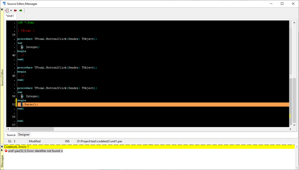

Hello.
I can't get auto-completion work properly.
Please check this out.
At least, It was OK with version 6.4.
# problem
"identifier not found" error often showed up.
# environment
CT 6.8, 6.7, 6.6, 6.5
Windows 10 64bit

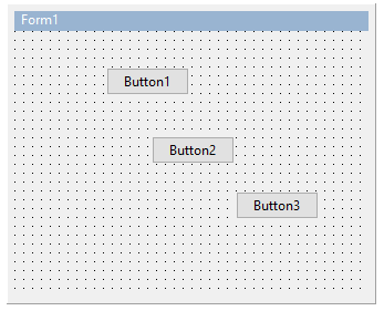

# To reproduce the problem
1. Create a new "Application" project
2. Place three buttons
3. Add click events
4. In the 3rd event, try to use auto completion function(check the attachments)
Problem with the Codetools 7 years 2 months ago #13553
please try and LAB CT ver 6.9 Revision 006860 info
has a lot changes in codetools source.
Problem with the Codetools 7 years 2 months ago #13555
  • LEE Haayoung
  • LEE Haayoung's Avatar Topic Author
  • Posts: 2
It seems to work fine!
Thank you for your hard work.
