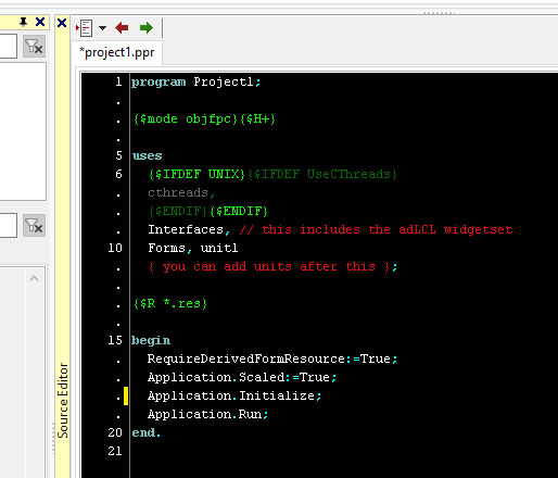

IDE Formular Designer Problem 7 years 5 months ago #13334
-Open Project Inspector
-Close all project open units and forms from CT
except main Project file *.ppr
-Save the project
IDE Formular Designer Problem 7 years 5 months ago #13335
  • Jörg Elspass
  • Jörg Elspass's Avatar Topic Author
  • Posts: 15
Tgreat, I did not think so
Is working!
