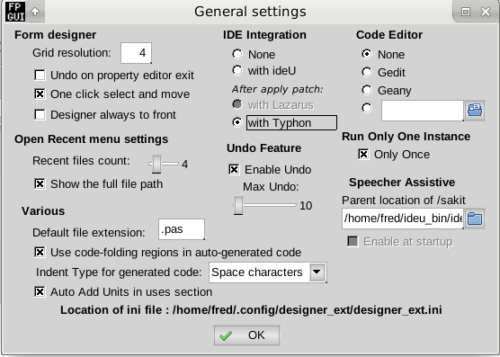

Hello.
There is the uidesigner_ext of fpGUI:
github.com/fredvs/uidesigner_ext
See in
/uidesigner_ext/patch/Typhon
There are patches for total integration into Typhon.
Sadly the patches for last releases of Typhon are on "todo" list.
But of course if Strenas if ok to add those very few code to enable total integration in Typhon, it is better.

  • Posts: 209
Last patch was for Typhon 5.6, more than 3 years ago.
So it is surely not up-to-date.
But for uidesigner_ext side, integration of Typhon is ready for ages yet:
Last edit: by fredvs.

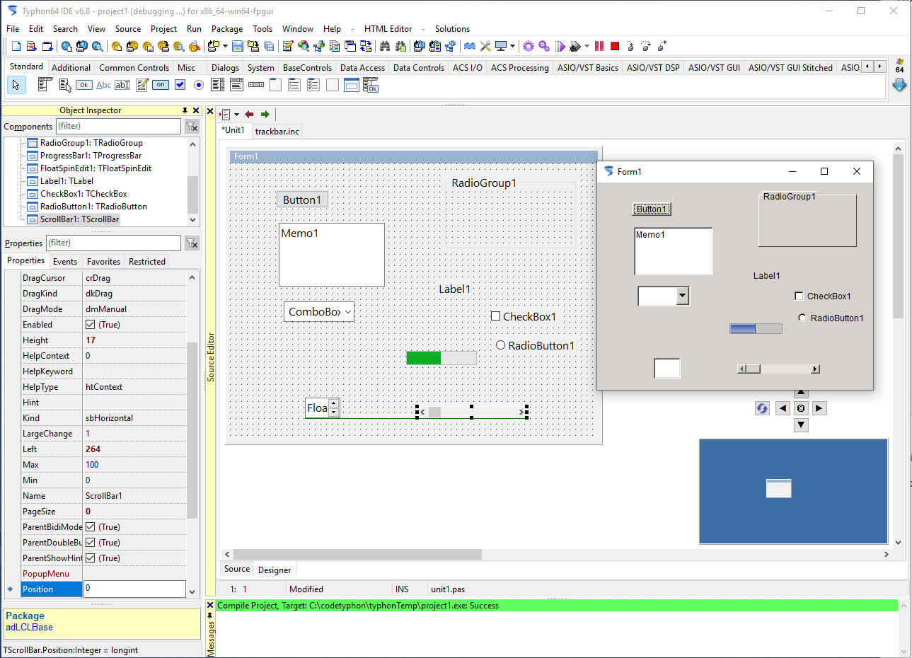

@Sternas : I see there on your picture a TfpgLabel. Does it mean that you found a way to deal with TfpgLabel too?
And the result, does it produce a "pure fpgui" or a "LCL-fpgui" application?
@gulyone: Thanks! About sak: for LCL widgets only a few are implemented.
fpgui support 7 years 5 months ago #13307
It's AdLCL application with fpGUI platform.
Yes TLabel works and in fpGUI platform now

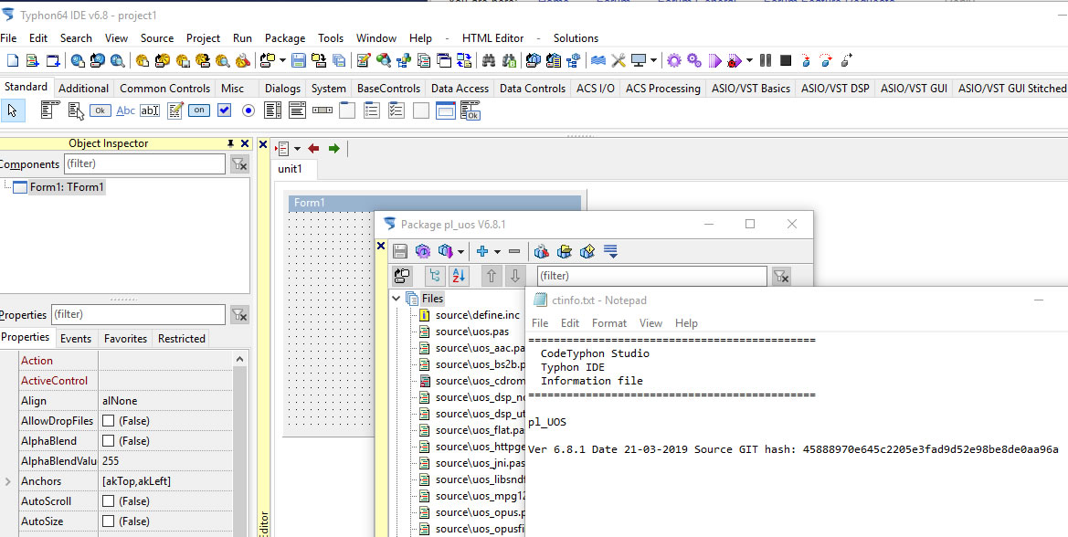

> fpGUI develop GIT (with MODs)
What kind of MODs?
fpgui support 7 years 5 months ago #13311
Read attach ctinfo.txt from fpgui_toolkit.ctpkg
and pl_AGGPas used by fpgui_toolkit it's our development work
a lot of work to keep CT FpGUI platform alive... ;) but you never know...
