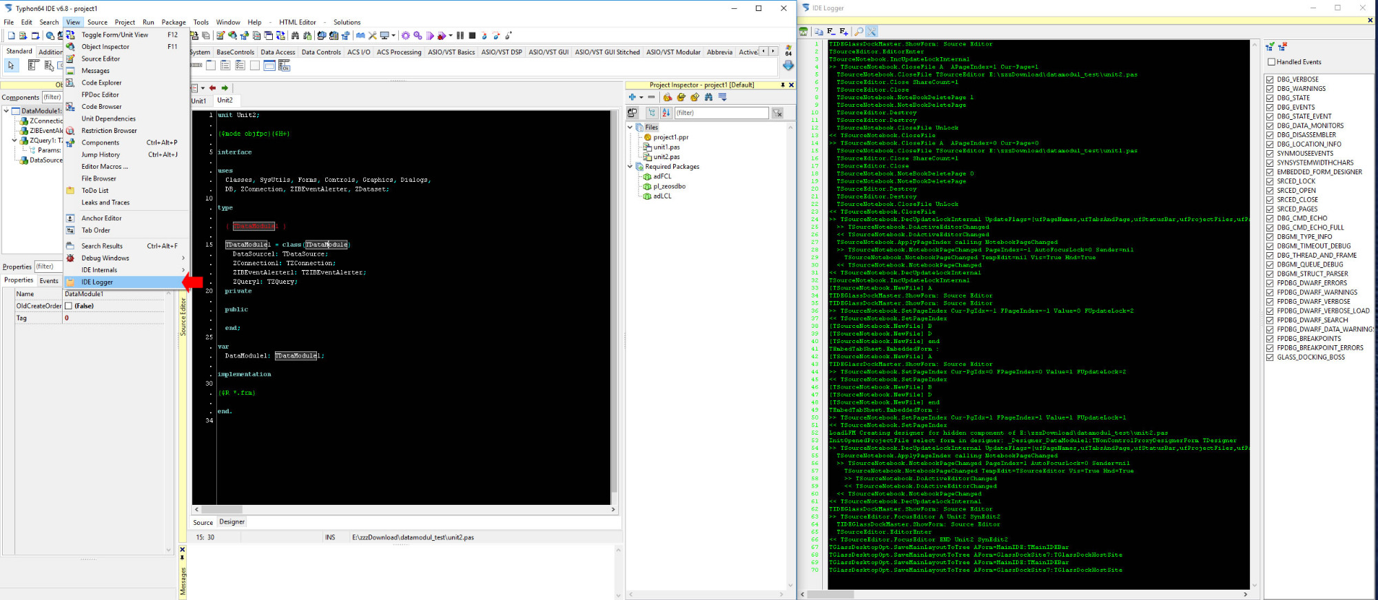

You can Open Typhon IDE => View => IDE Logger
to test and debug IDE Loading Forms procedures of your project

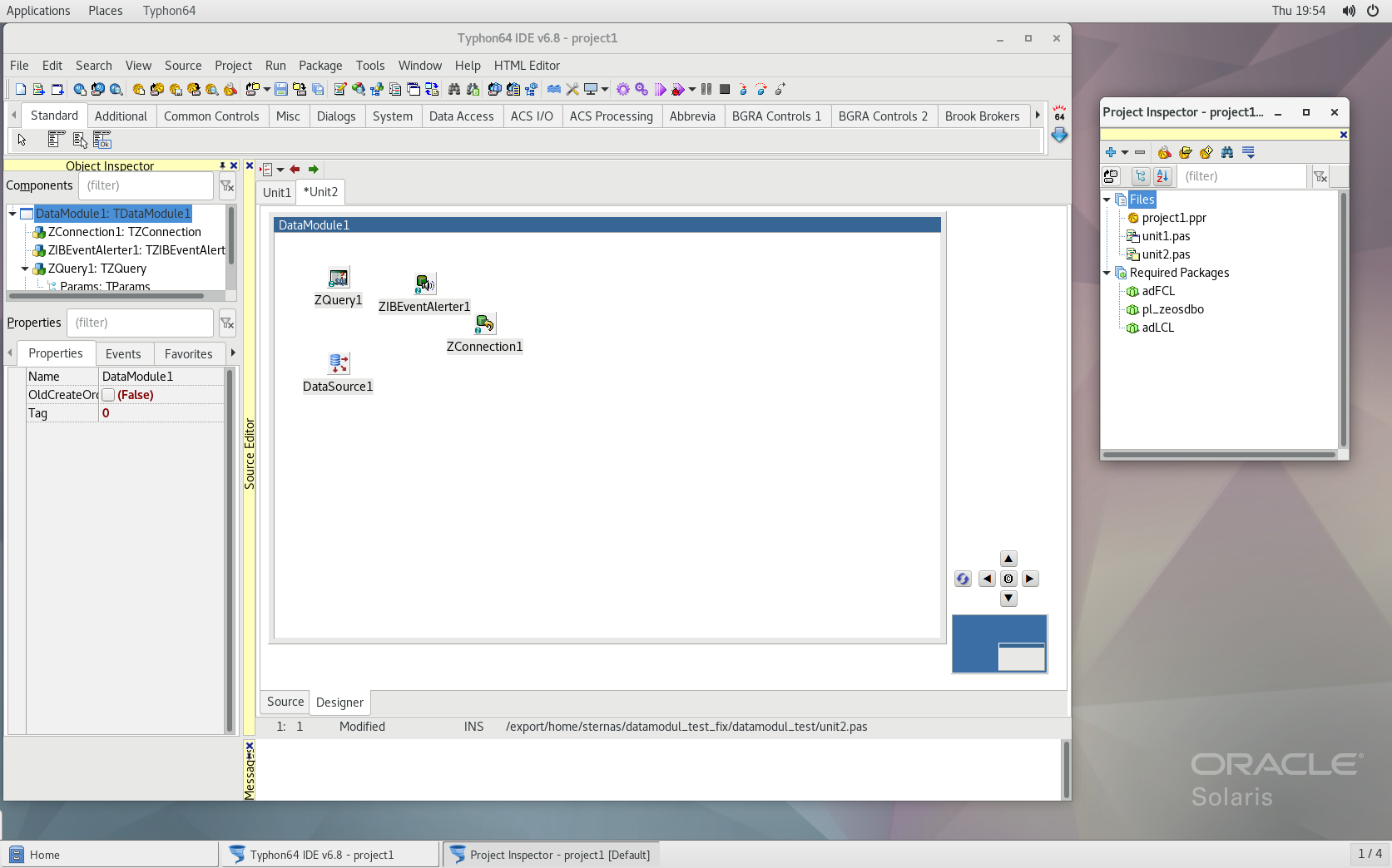

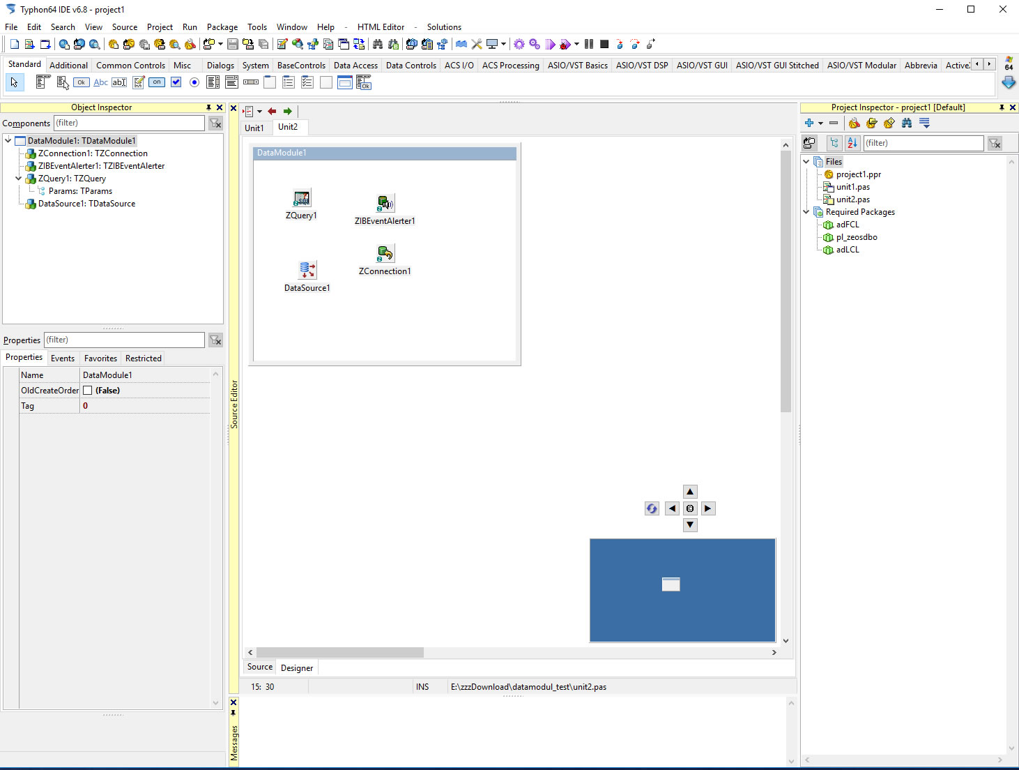

LAB CT 6.8 with Typhon64 on Win10 with your fixed project
and your fixed project on Solaris 11.4 64bits (same as above LAB CT 6.8 and Typhon64) :woohoo:
