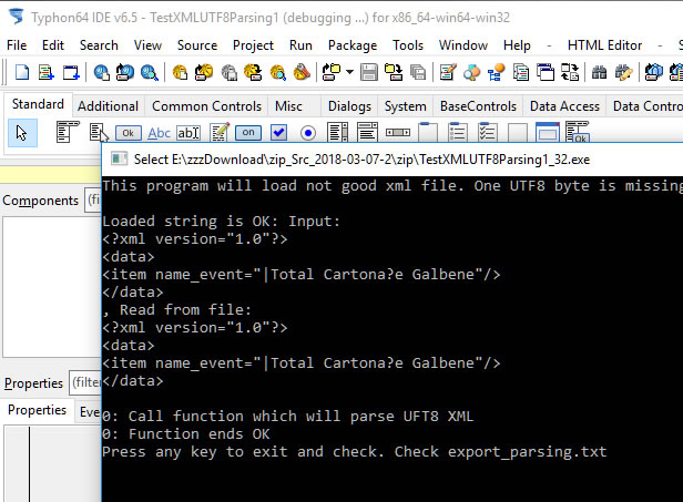

I have problem with CT640 and UTF8 xml parsing. It seems that UTF8 from CT640 is loosing characters or something is changed deeply in fpc, but I do not know what.
This happen from time to time when CT use new version of fpc trunk.
I included test project, so you can compile it to test and confirm.
Result of program is (one character is lost)
Should be, name_event=|Total Cartonașe Galbene
But it is, name_event=|Total Cartona?e Galbene
Regards, Dinko

Encoding is UTF8
File Name: export_par...08-2.txt
File Size:0 KB
File Name: UTF8ChartTestSave.zip
File Size:0 KB
I tried with header
<?xml version='1.0' encoding='UTF-8' ?>
a get the same result.
CT600 - does not have that problem.

I found the line position where starts to appear.
It seems that UTF string is wrongly converted.
Maybe, I need to put some application Encoding setting, but I do not know how.
c:\codetyphon\fpcsrc\rtl\objpas\classes\streams.inc
CT640
constructor TStringStream.Create(const AString: string = '');
Create(AString,TEncoding.Default, False);
CT600
Inherited create;
FDataString:=AString;
UniqueString(FDataString);
laz2xml_read.pas calls this function
procedure TXMLReader.ConvertSource(SrcIn: TXMLInputSource; out SrcOut: TXMLCharSource);
SrcOut := nil;
if Assigned(SrcIn) then
if Assigned(SrcIn.FStream) then
SrcOut := TXMLStreamInputSource.Create(SrcIn.FStream, False)
else if SrcIn.FStringData <> '' then
SrcOut := TXMLStreamInputSource.Create(TStringStream.Create(SrcIn.FStringData), True)
else if (SrcIn.SystemID <> '') then
ResolveEntity(SrcIn.SystemID, SrcIn.PublicID, SrcIn.BaseURI, SrcOut);
if (SrcOut = nil) and (FSource = nil) then
DoErrorPos(esFatal, 'No input source specified', NullLocation);
If I manually convert string into stream and works with that stream everything works as expected, but I need to do it everywhere in source.

Not all Delphi solutions are good one. They need to support windows platform which use utf-16, so they did. Everything else is pure alchemistry.
SrcOut := nil;
// SrcOut := TXMLStreamInputSource.Create(TStringStream.Create(SrcIn.FStringData), True)
SrcOut := TXMLStreamInputSource.Create(TStringStream.Create(SrcIn.FStringData, CP_UTF8), True)
So my temporary solution for CT640 is to change this procedure in laz2_xmlread.pas.
I'm afraid this is not the end of UTF-8 problems in near future. It should be great that I can detect code page of xml document and pass it to procedure. Since I use only UTF-8, this solution works with my old CT600 code.
Regards, Dinko
