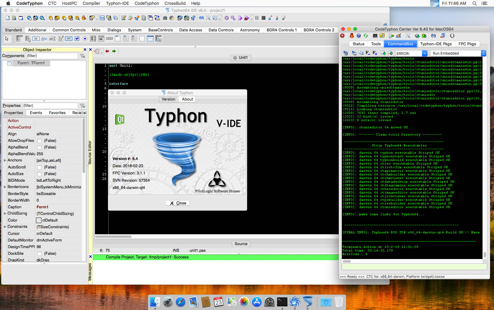

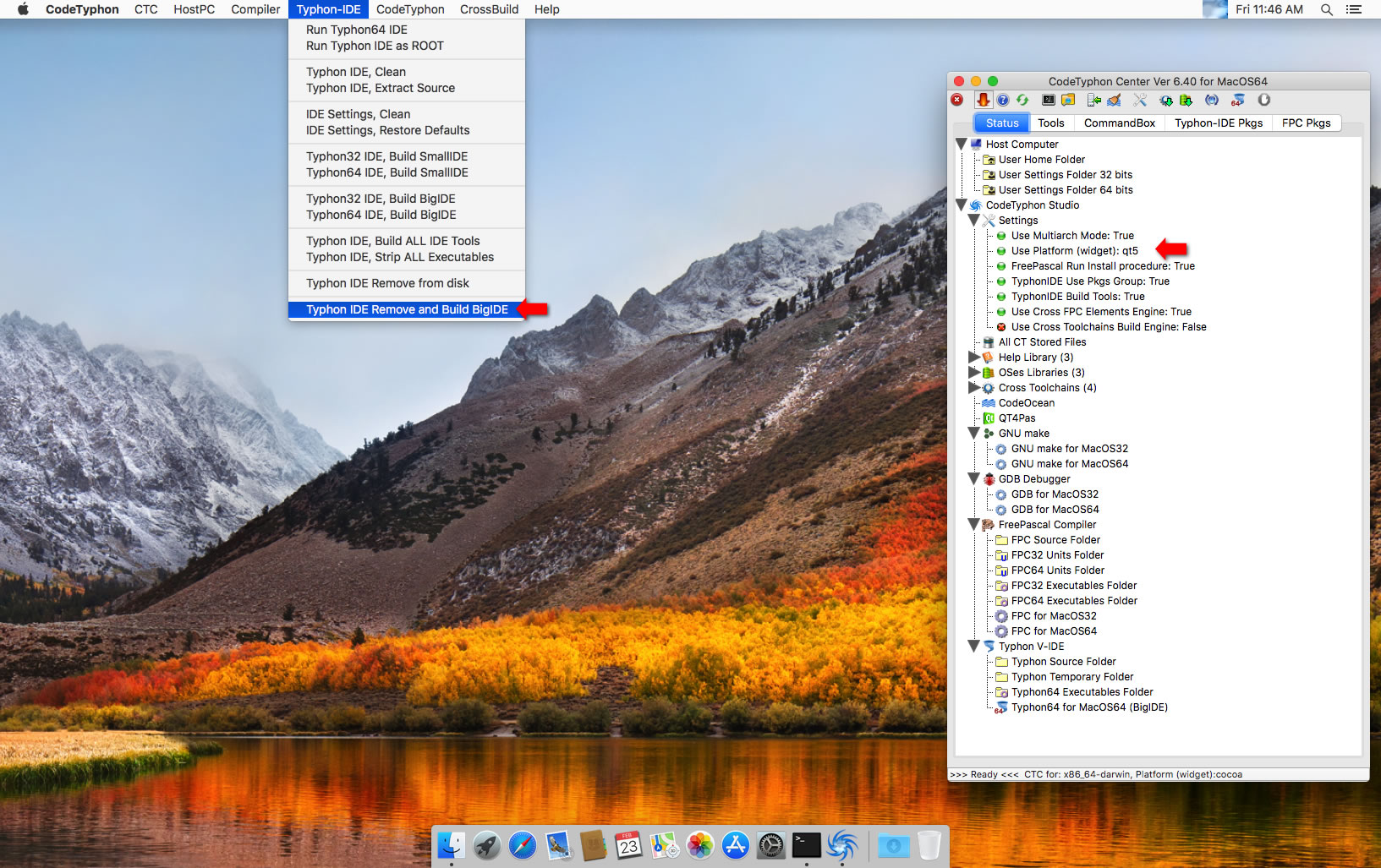

Now I finish my test with Typhon64 for QT4 on MacOS 10.13.3
and I will "remove and build" Typhon64 for QT5 on MacOS 10.13.3
for our tests...
