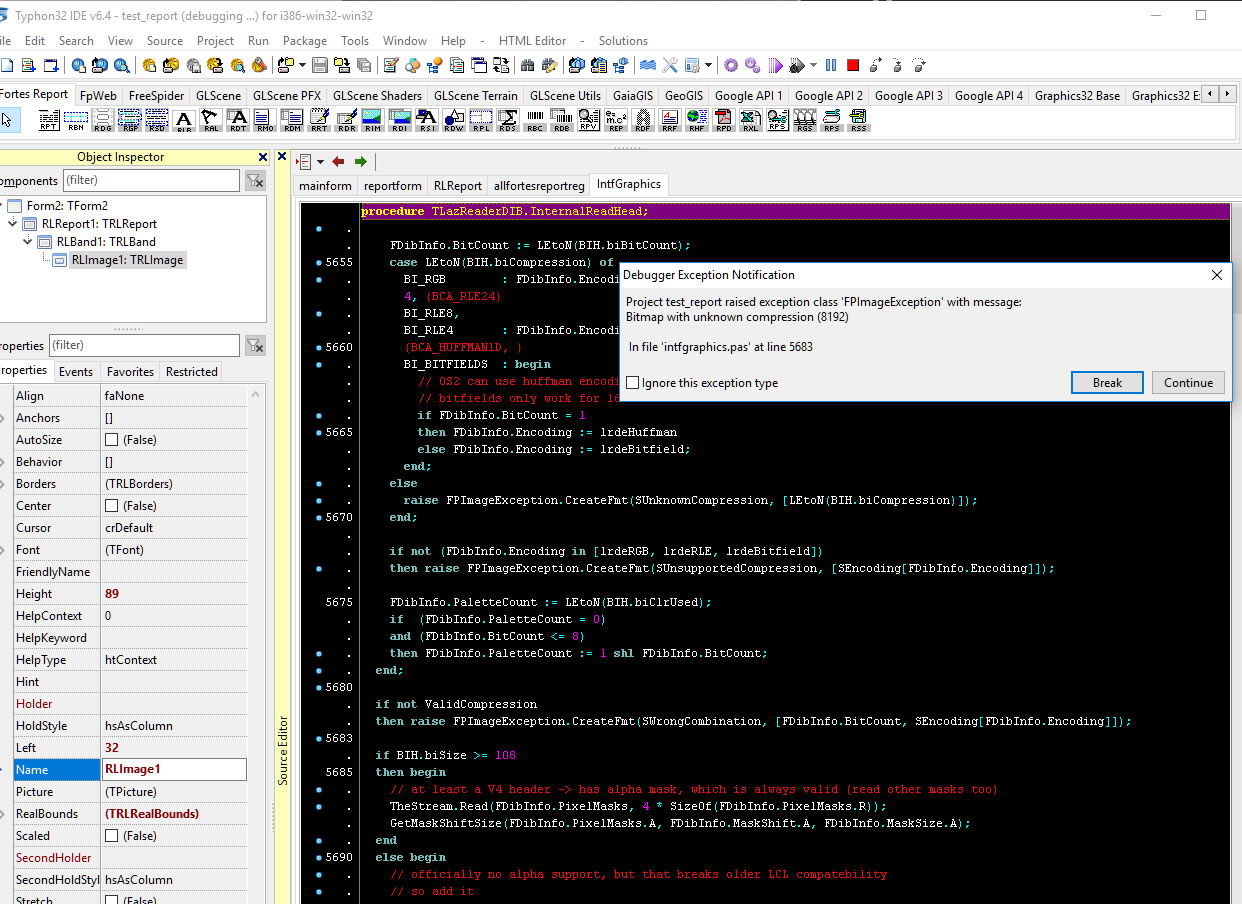

Hi.
I ported a small app with a report from CT 5.8 to CT 6.3 .I use a report with a header, using the TRLImage (single image from Fortes Report page) for print a small image on top. The app work fine with CT 5,8 but into CT 6,3 display a error (into intfgraphics.pas) when try to print the report-page:
"Bitmap with unknown compression". I try to change the image, but the error continues. If the "picture" propertie of TRLImage is blank, then the report print without error.
Last edit: by Ramon Retamar.

¿ Bug in TRLImage component ? 8 years 8 months ago #11331
your test app give us the same Error
Please give us time, we will try to fix this
PS: and sorry for the delay...
