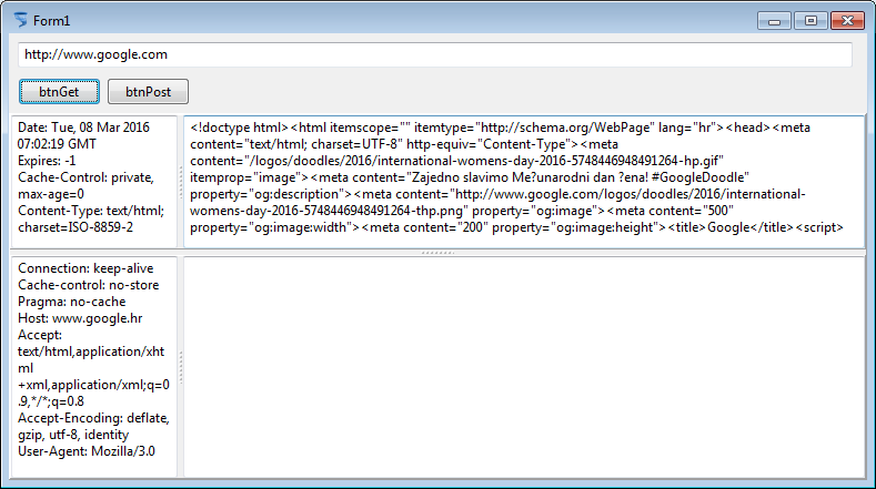

I'm using CT570 on Windows 7 OS. I compile applications on CT570 Win32 for Win32, Win64 and Linux32, Linux64.
I tried to compile my projects with CT570. Last successful version form me CT540. After that I tried every version and I always found some problems.
This is the case with this version also. Some things are corrected (like Postgres Float (BCD) reading on Win64, string memory leaks from CT560, etc...
I have two major problems:
1) Problem with Indy components. It seems that this version of indy components can not work with gzip response from server and also it can not handle https requests.
So I removed Indy and install version which from CT540. Now application works correctly.
2) Debugger problem.
I can not start any my GUI application in debug mode.
I can compile application in debug mode, and I can compile application in release mode.

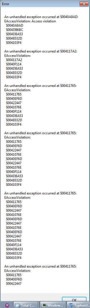

If application is compiled in debug mode then application non stop reports white access violation dialog (picture 1). I need to kill it in task manager
If I try to start appliication in debug mode then debugger reports an error (see picture 2)
If application is compiled in release mode then it works correctly (Win32 and Win64)

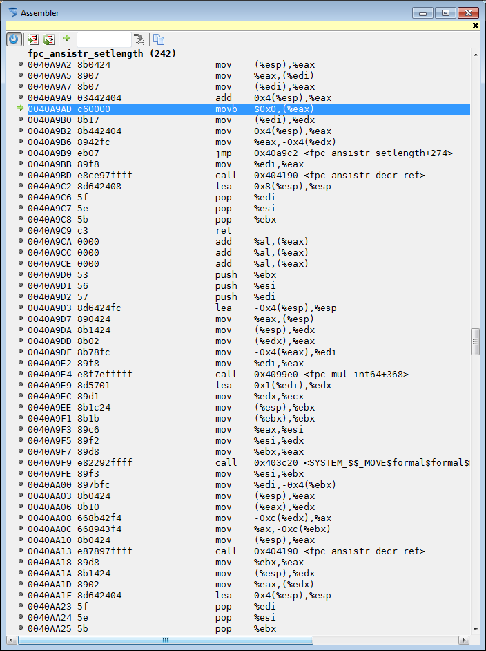

I found source of debugger problems. All my applications use cmem memory manager because it consume less memory then standard.
If you want to reproduce debugger problem, then just put cmem to any gui application and you can not debug even first line of application.

my suggestion is NOT use cmem on Windows with Debugger
Any help project for Indy problem(s) ?

What do you suggest about cmem. How reliable is to use cmem in production. Can you suggest some compiler switch which I can put before cmem when I want to debug. For example ifdef debug then cmem othwrwise ...

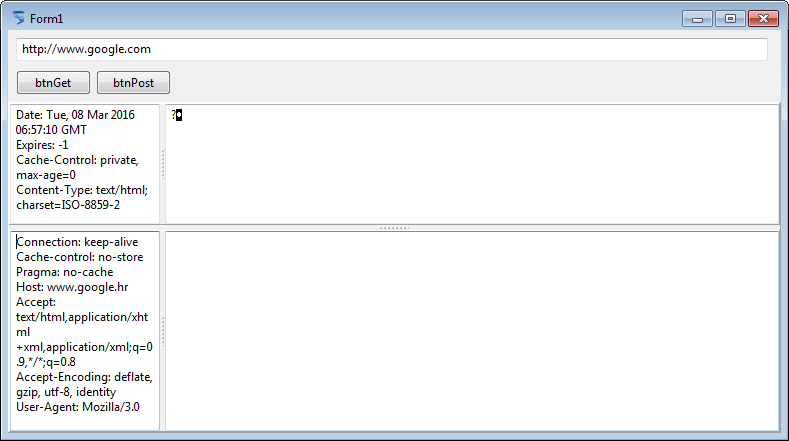

I send you demo program which can reproduce indy behaviour. If you request gzip in http server response then you get uncompressed response which is not correct
Regards, Dinko

For "cmem" my suggestion remain, after last changes to FPC some libraries must
re-coding
