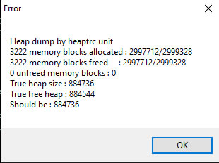

So as title says: I tried to use FormatDateTime function in a thread and found out it is not thead-safe, no matter what delphi documentation says (fpc/Lazarus documentation doesn't say anything at all regarding thread-safe usage). Even using the function with its own TFormatSettings variable (again as Delphi documentation suggests) doesn't help in CT.

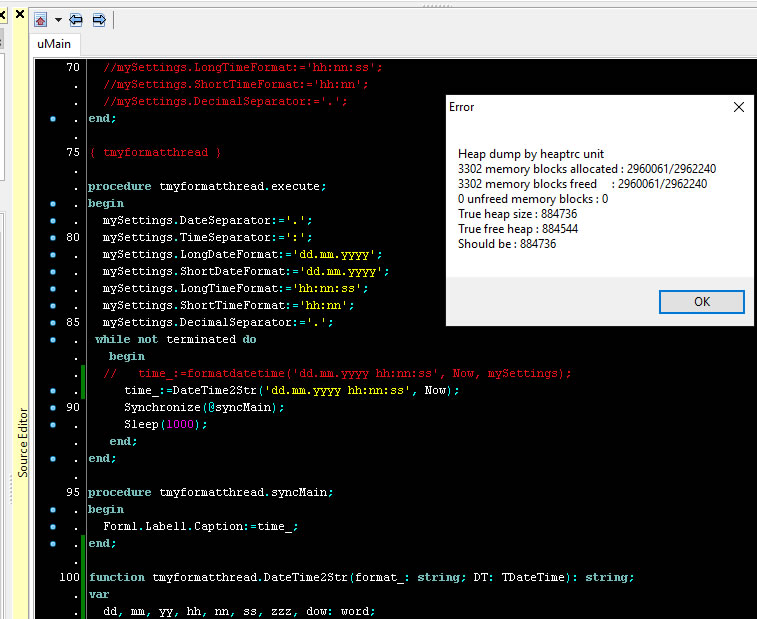

P.S.S. Wrote something fast to fit my needs, so anyone can feel free to use and/or modify it...
function tmyformatthread.DateTime2Str(format_: string; DT: TDateTime): string;
var
  dd, mm, yy, hh, nn, ss, zzz, dow: word;
 function LZ(What: Integer): string;
   result:=IntToStr(What);
  if What < 10 then result:='0' + result;
  DecodeDateFully(DT, yy, mm, dd, dow);
  DecodeTime(DT, hh, nn, ss, zzz);
  result:=format_;
  result:=AnsiReplaceText(result, 'yyyy', LZ(yy));
  result:=AnsiReplaceText(result, 'yy', LZ(yy - 2000));
  result:=AnsiReplaceText(result, 'mm', LZ(mm));
  result:=AnsiReplaceText(result, 'dd', LZ(dd));
  result:=AnsiReplaceText(result, 'hh', LZ(hh));
  result:=AnsiReplaceText(result, 'nn', LZ(nn));
  result:=AnsiReplaceText(result, 'ss', LZ(ss));
  //result:=LZ(dd) + DateSeparator + LZ(mm) + DateSeparator + LZ(yy) + ' ' +
          //LZ(hh) + TimeSeparator + LZ(nn) + TimeSeparator + LZ(ss);
It's not perfect, but for a couple of minutes, it works perfectly.

It's set to use HeapTrc unit (-gh) in Project Options -> Debugging. Upon program close it will show a message box with the freed RAM

It's perfect, but please, test it with fpc FormatDateTime function. It leaks. Mine is slow, but doesn't leak any memory.

the previews screen is with
time_:=formatdatetime('dd.mm.yyyy hh:nn:ss', Now, mySettings);
this screen is with
time_:=DateTime2Str('dd.mm.yyyy hh:nn:ss', Now);
CodeTyphon Lab 5.70 revision 5621, Windows 10 Pro 64bits, Typhon64

You mean
doesn't make any leaks? What version of CT and FPC are you using? Haven't seen this in bug tracker, or I missed something O.o
FormatDateTime in a thread - any way to use? 10 years 10 months ago #8879
all above tests are with CodeTyphon Lab 5.70 revision 5621, Windows 10 Pro 64bits, Typhon64 info

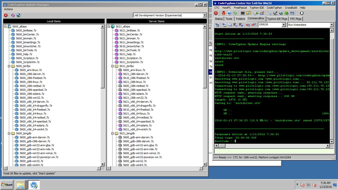

For CodeTyphon we use a Flat-Line Rolling Development Model
Please
-download CT 5.60
-install CT 5.60, !!! DON'T build anything !!!
-Update with CTCenter, to lab CT 5.70 revision 5621
-Build ALL

Tried what you sugguested, but unfortunately CT 5.6 only allows update to LAB version 5.6.2.1 and not to 5.7 :(
Any other ideas?

until the final release of CT 5.70, the revisions are 0056xx :)
We will close Lab Version with CT 5.70 Final-Stable and revision 005700

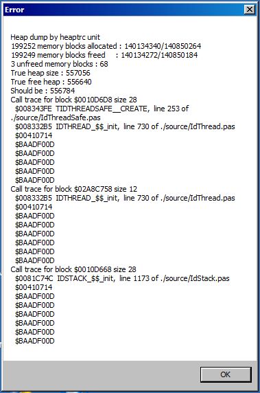

Report on LAB ver. 5.7
Everything seems to work smoothly (no memory leaks, except the TidHTTPServer, but it's an old one and is a one-time only -> seems the shutting down doesn't actually shut down the TidThread and other stuff property, see the picture below) except... encoding from UTF8 to Sys. Here's my scenario:
server uses Postgresql as a DB server and stores data in UTF8 (as usual).
This server "talks" via JSON to a Delphi XE7 application, which cannot understand UTF8, so characters must be encoded to, let's say UTF8ToSys. Seems like this function doesn't encode anything, because client sees the characters as garbage (UTF8 non-readable). This one didn't present back in CT 5.5 with ZeosDBO 7.2.1 stable. If I decode the string client-side everything seems to work (tried with several fields and they're displayed correctly). Maybe I'm missing something?
