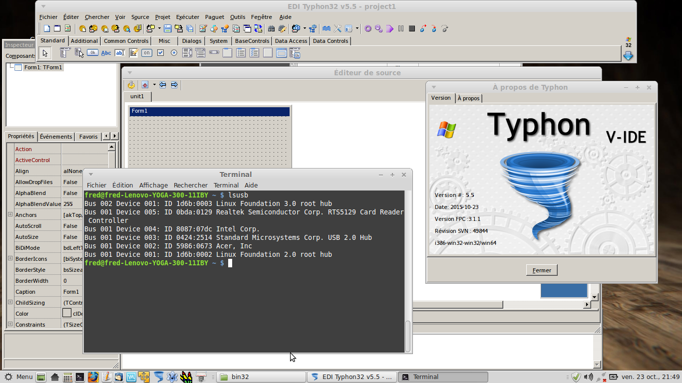

Install CT via Wine ? 11 years 4 weeks ago #8424
  • Fred
  • Fred's Avatar Topic Author
Hello Sternas.
Of course, there is no fire ;)
Here how I do :
1) Boot on Windows.
2) Install CT on Windows 8.1
3) Boot in Linux
4) Copy directory /media/fred/WIN81/codetyphon into /home/fred/.wine/drive_c
And the result if running => wine /home/fred/.wine/drive_c/codetyphon/typhon/bin64/typhon.exe => (see attachment)
So, it works.
It would be perfect if there was no need to install CT first to Windows then copy to Linux but instead directly install it to Linux via wine /CodeTyphonIns/install.bat
PS: No worry, the most important is that it works already with copy installed-CT-directory-in-Windows into Linux-directory.
Thanks.
Fre;D

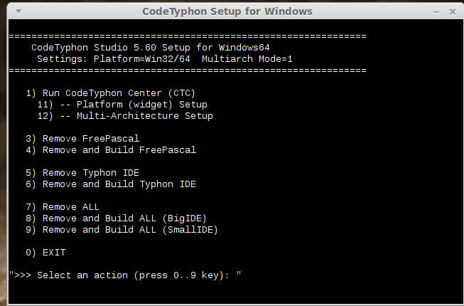

Install CT via Wine ? 10 years 11 months ago #8658
  • Fred
Ok, it is possible to install CT-Windows via wine Linux/FreeBSD. ;-)
The tip is to add the missing ".bat" extension when a batch script is called with "start" in setup.bat and each /ScriptsWin/*.bat
Example in setup.bat : Change this =>
START /B /WAIT xx_CodeTyphon_Remove_FPC
with that =>
START /B /WAIT xx_CodeTyphon_Remove_FPC.bat
That way, wine can find and run each script and CT-Windows can be installed on a Linux/FreeBSD system via Wine:
cd /directory/of/CodeTyphonIns
wine wineconsole.exe install.bat
Perfect, all is installed and working.
In attachment, all the Windows scripts of CT 5.6, working for "real" Windows OS and for Wine in Linux/FreeBSD.
PS : Procedure => @ Run CodeTyphon @ in setup.bat is a litle modified too to work for Wine too.
PS2: It is real plus for CT to be installable via wine.
Fre;D
[EDIT] X2 => Added new attachment tested on Linux Mint 64 => both Typhon32/win and Typhon64/win correctly installed.
Last edit: by Fred.

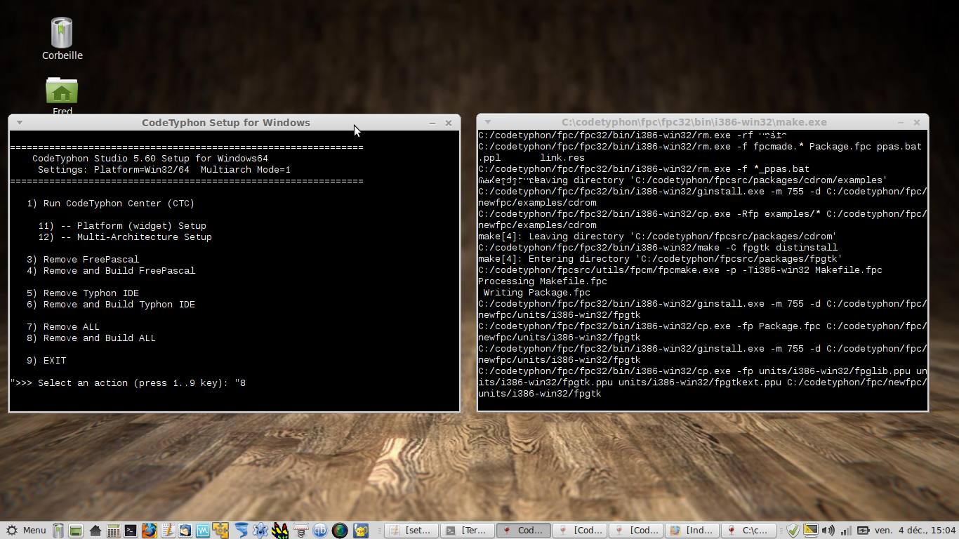

Install CT via Wine ? 10 years 11 months ago #8659
  • Fred
Re-hello.
In attachment, Windows-scripts tested and working.
In setup.bat, added a option to Clean - Build all (SmallIDE).
I know that it is possible to do it via CodeTyphon-center, but it is faster in console.
Fred.
[EDIT] Update attachment (Windows-scripts => some ".bat" ware missing.... :huh:
Last edit: by Fred.

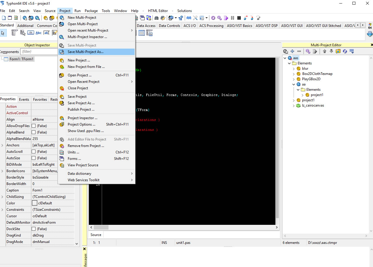

Install CT via Wine ? 10 years 11 months ago #8668
A Screen from
Windows 10 Pro 64bits
Install CT via Wine ? 10 years 11 months ago #8669
  • Fred
A Screen from
Oops, seems very interesting (but I do not know that "Multi-Projects" concept).
I will check on Wikipedia. (maybe it is something like Git-concept).
Congrats for that new way.
Fre;D
