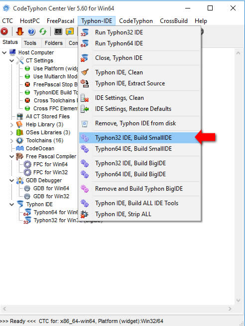

-Build Typhon Small IDE (not BIG IDE) from CTCenter (1-2 min).

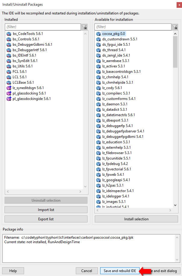

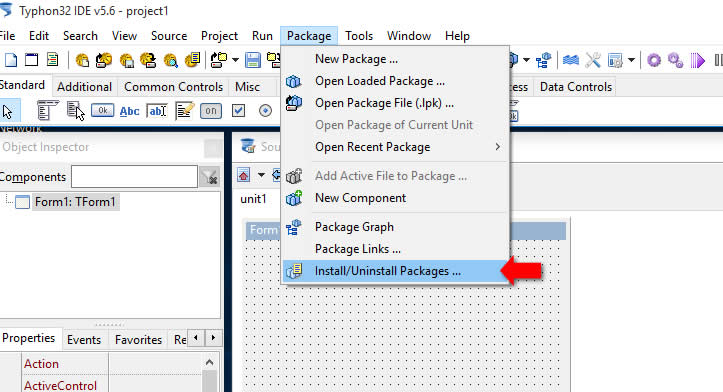

-Open Small IDE and select the packages you want to have the big IDE.
-Rebuild Typhon IDE.
You will get the BIG Typhon IDE with your packages
