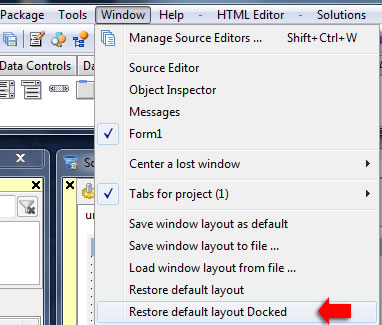

How is docking supposed to work in IDE? 11 years 5 months ago #7259
Or go to Typhon IDE->Window->Restore default Docked
it's very simple
