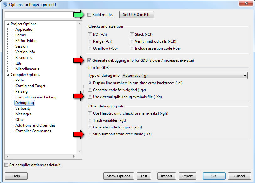

first of all my suggestion is to use always the latest CodeTyphon (5.2 now)
When I compile similar files I've recently ported to Typhon, the executable files are 7.5 and 10 Mb in size
Do you have debugging info in your project ?
CT by default store application debugging info in to executable
In Project Options=>Debugging
you can find more options like
-"Use external gdb debug symbols file". In this case ALL debugging info stored to external file NOT in executable file
-"Strip" debugging info/symbols from executable
-Use "Build Modes".

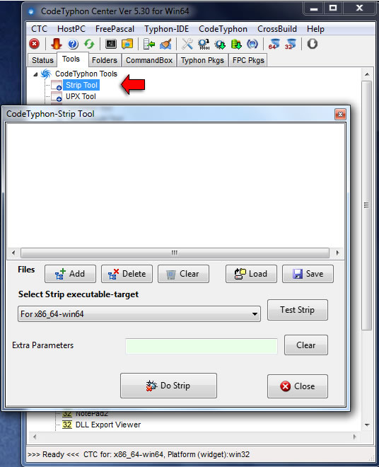

and finally always you can use CTCenter=>Tools=>Strip Tool
to remove debugging info from executables,
just drag-and-drop the file to dialog and hit "do Strip" button
