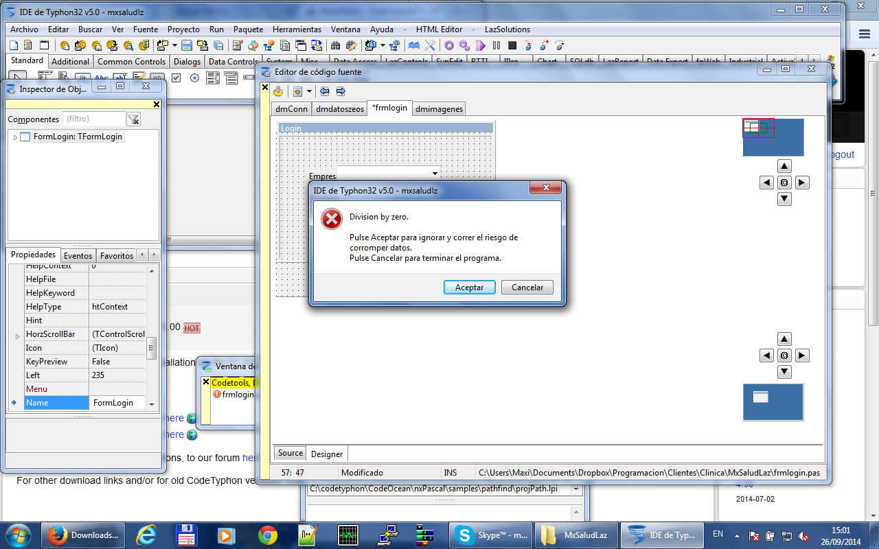

This error appears.
Sometimes when I change a property, or when the form is displayed in design mode.

and if press cancel. Crash IDE, if press Accept continue
