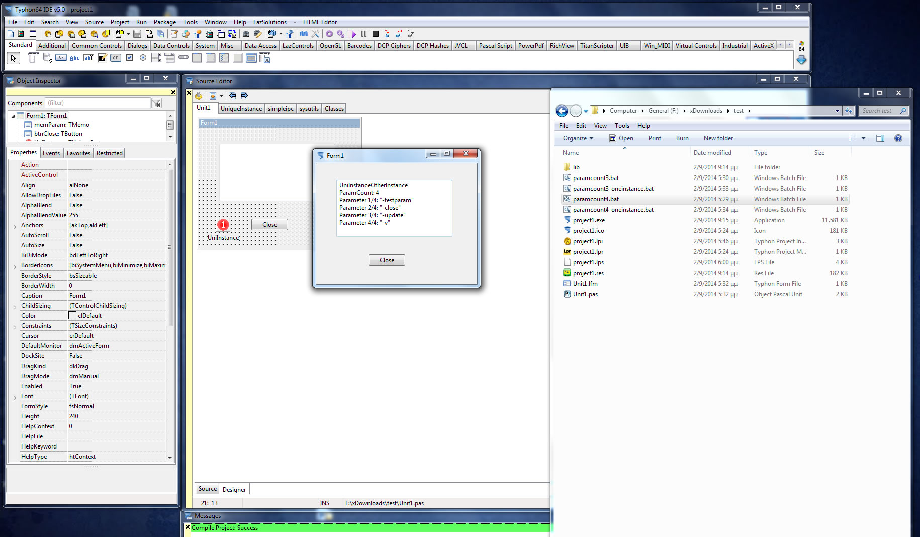

I develop Win/Lin application and I use UniqueInstance in it. I started to use CodeTyphon 4.9 for easy cross compilation (thanks for that). But I found out that the UniqueInstance doesn't pass parameters. It passes number of parameters but the array of parameters is empty. When code compiled with FPC 2.6.2 UniqueInstance works fine. Simple code is attached. Executable is compiled with CodeTyphon 4.9. Can someone help me with it. Thanks in advance.

All OK here Sir
CT Lab 5.00 Revision 004970-004975
