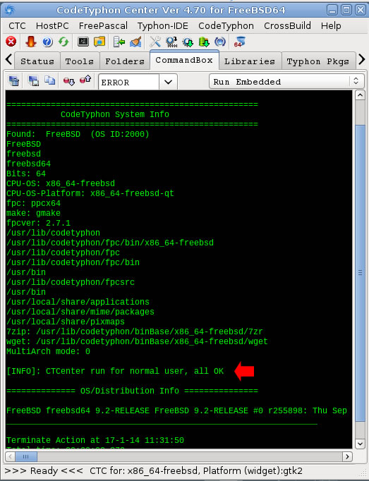

For me, on Ubuntu 14.14 x64 the build is ok but when i start CT it complains about missing fpc.cfg. The file is there and it is not empty. What can i do?
Thank you.
UPDATE: I have found an workaround. I have started typhon64 using sudo and it worked. Then when i started the IDE under my user it failed. So i had to
sudo chown mdalacu:mdalacu -R .typhon64
and then it worked properly. Is this normal behavior?
Thank you.
Last edit: by Marius.
CT 4.7 12 years 9 months ago #5030
@universe
we want your tests result and your help to make CT better...
CT 4.7 12 years 9 months ago #5031
@mdalacu
No, this is not normal behavior Sir.
Please reinstall CT us "Normal User" with sudo root permitions
You can check if all OK from: CTC->HostPC->Get System Info
this screen is from FreeBSD-64 but has the same functionality
