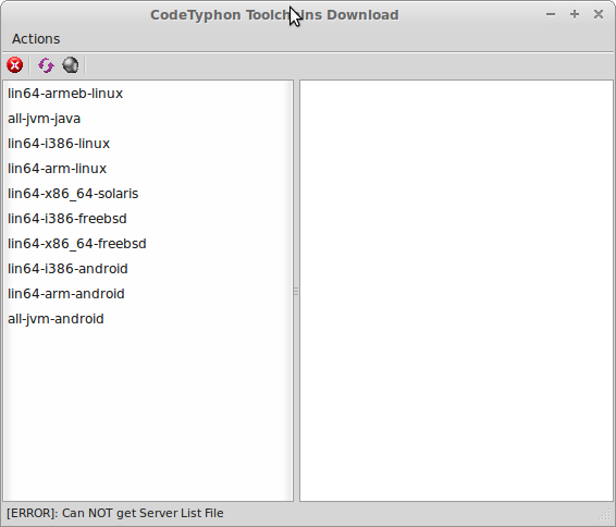

CodeTyphon 4.00 GEN IV 13 years 5 months ago #3261
  • Dibo
  • Dibo's Avatar
  • Posts: 37
I just updated CT from 3.10 to 4.0 (clean installation) and I'm confused how to create cross elements now. In 3.10 I had full lists of all elements but now it is very short, no windows targets (I'm running CT on Linux Mint 14 64 bit, XFCE Edition). So I looked to the refreshed help about CT Studio. Tried download new targets, but after refresh, my list is still short (se attached screen). And output (translated from Polish):
[INFO]: CodeTyphon Download Engine settings
1
www.pilotlogic.com/codetyphon/toolchains/zzctdirver.ctv
x86_64-linux
zzctdirver.ctv
xxxx5
xxxx6
[INFO]: Download file, please wait..
sudo: missing tty and unknown password program
/usr/lib/codetyphon/ScriptsLin/ln_xCodeTyphon_UDownload.sh: line 28: cd: zdownload: No such file or directory
Terminate Action at 11-2-13 15:00:21
Total time: 00:00:00.108
ExitCode : 0
Same with building target:
GNU Cross toolschains Engine settings
lin64
x86_64-linux
xxxx
i386
win32
xxxx
i386-win32
BinUtils Build for i386-win32
/usr/lib/codetyphon/ScriptsLin/ln_Cross_Binutils.sh: line 50: cd: /usr/lib/codetyphon/CrossEng/binutils: No such file or directory
/usr/lib/codetyphon/ScriptsLin/ln_Cross_Binutils.sh: line 56: ./configure: No such file or directory
[ERROR]: Sorry, Toolschains for i386-win32 NOT Build...
Terminate Action at 11-2-13 15:04:34
Total time: 00:00:00.114
ExitCode : 0
