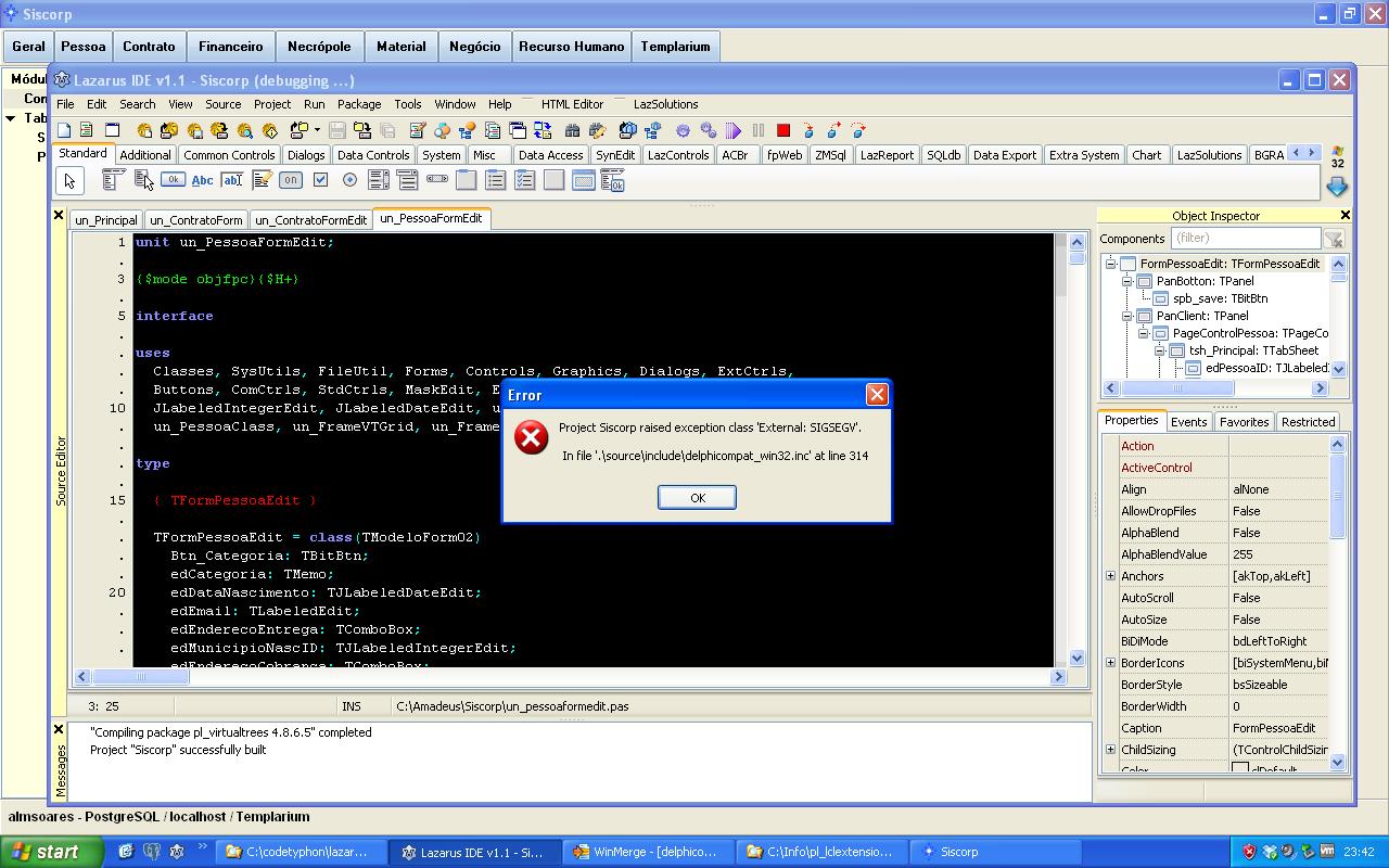

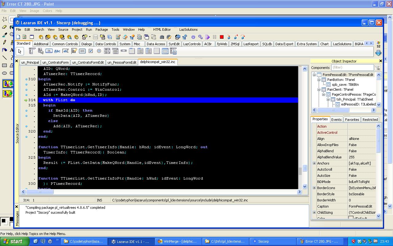

First of all, I can see the dawning of the most powerful Programming Studio on this planet. Congratulations for your team, they are the master of this great work.
I work with CT 2.70 and today I tried to use CT 2.80.
After the first shine of glory, I needed to do a small correction in CT 2.80.
Is just copy this part of code of CT 2.70 to CT 2.80 and thats ok. After this, the error do not occurred anymore.
C:\codetyphon\lazarus\components\pl_lclextensions\source\delphicompat.pas
CT 2.70
{$i delphicompat.inc}
initialization
FTimerList := TTimerList.Create;
{$ifdef DEBUG_DELPHICOMPAT}
Logger := TLCLLogger.Create;
Logger.Channels.Add(TFileChannel.Create('delphicompat.log'));
Logger.ActivateClasses := [lcInfo,lcStack];
Logger.MaxStackCount := 3;
{$endif}
finalization
FTimerList.Free;
Logger.Free;
{$endif}
end.dif}
end.

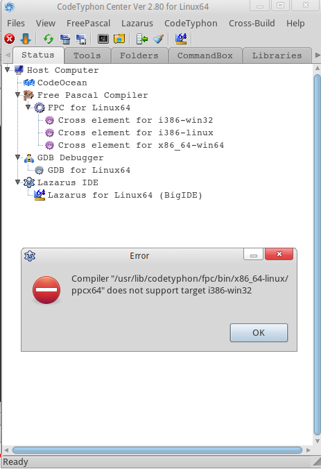

Since I also have one small correction for CT 2.80 I would not open new topic.
I installed those 3 cross elements:
i386-win32
i386-linux
x86_64-win64
When I tried to compile for win32 I got error Compiler "/usr/codetyphon/fpc/bin/x86_64-linux/ppcx64" does not support target i386-win32
Fix is very simple, you should just replace Compiler path line.
Please replace
/usr/lib/codetyphon/fpc/bin/x86_64-linux/ppcx64
with
/usr/lib/codetyphon/fpc/bin/x86_64-linux/fpc
