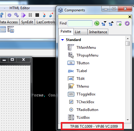

CodeTyphon is a large Programming studio
only the source after installation has size 1.6 Gbytes
after build BigIDE has about 2.5-3.5 Gbytes
with 86 Pages and 1009 Visual Components
