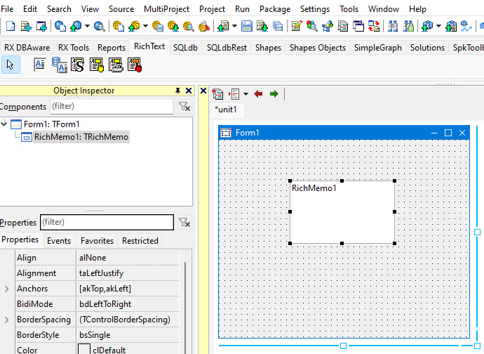

Wow, it's done.
When I start BigIDE again from CTC, "Palette = RichText" appears, and there are TRichMemo and TDBRichMemo.
Thanks, Mr. Stefanos.
After I installed CT7.6, I was launching CT from a shortcut prior to 7.6. And I thought it was Big IDE. But it wasn't Big IDE. I now know that was the cause. It was totally pathetic.
